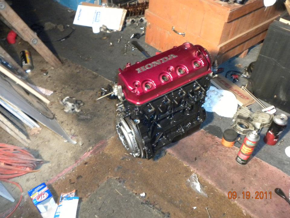

Betsy's donor heart, just about ready for transplant. Needs a new crank position sensor, cam covers, and timing belt put on.

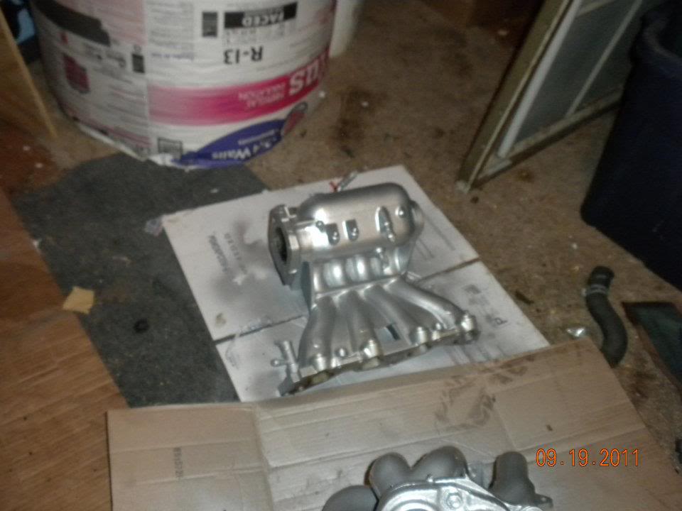

y8 Intake manifold, high metal flake aluminum with 2000 degree primer under.

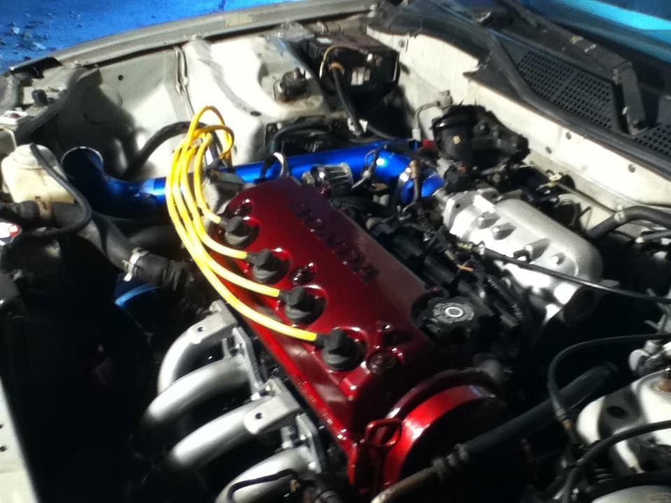

i am proud to say, Betsy at 9:00 last time, turned key back fired, needed her wires corrected and started up on the second shot!
shes got a rough idle but im kinda pissed that i didnt know 7ys have no knock sensor because i didnt put one on and ive got an open wire and im doing a 2000 miles journey with her next week. would a knock sensor cause rough idle. i did just adjust the ignition timing by turning the distributor backwards, toward the trunk, and she did calm down a lot but shes still seaching for idle. i need to get her off jack stands so im not vibrating her off em without out her wheels on, so thats the plans for her right now. i wanna be able to get her warm so i can really see whats going on. iacv? its hooked up. map sensor? hooked up. she has iridium ngks in her, neuaspeed wires. shell venture down to 750ish and rise all the way to 1500. up and down the whole time. but like i said after i calmed her down by messing with the dizzy, i said enoughs enough till i get her hooked up right and on 4 wheels. ill be driving her later tonight. i know 2 true honda gurus that i could take her too after i got her realigned, dont wanna eat up the new kuhmos.
after shes warmed up ill see her reaction and maybe mess with the idle air screw on the tb.
I JUST WANNA DRIVE HER! SHES SO PRETTY WITH HER AEM COLD/RAM AIR AND HER YELLOW WIRES!!! gah!
help?

sorry I never noticed this thread or I would have commented earlier. I had some of the same problems when I did this swap
I was told that everytime you torque the head down to the block you need to do a valve adjustment. When my car started up it was idling like crap and stalling at every stop. After I did a valve adjustment, it ran fine. might wanna give a once over to make sure you didnt miss any vacume lines anyway for good measure. I believe there is PCV/brake booster/EVAP system/fuel pressure regulator for vaccume lines. Also make sure the TPS and MAF sensors are not switched because the plugs are the same.
I also had a coolant leak in the back of the engine. I had 2, one from a missing hose clamp on a hose pointing upward that expanded when heated, and one from not tightening the IM bolts in the right sequence.
with a knock sensor CEL, your car should still run fairly well, it wouldnt cause stalling. The computer would just retard timing by a slight bit, and vtec will not engage. I had a hell of a time with the knock sensor and never did get all the bugs out. my knock sensor was aftermarket, DEFINATELY go oem on the knock sensor. If you get false knock like I did at random times, try relocating it to someplace not on the block but that still gets vibration. Before my car got wrecked I was about to try and make a custom knock sensor mount to attach to the alternator mounting bracket, I read others have done this with success.
