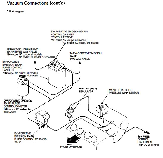

OP, if you have an EVAP system, you also might want to inspect the vacuum lines.

OP, does your Civic have an EVAP system?

I don't believe so, where would it be located?

This should give you a sense about what EVAP components in the engine bay look like:
