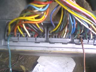

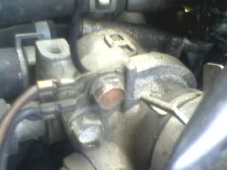

Well it will be nice once its done, it just sucks pretty much buying a few things at a time lol. Any ideas where to get the vtec wiring as I was unable to off the harness. Any ideas
Old Nov 22, 2009 | 11:08 PM
are you converting to obd1?
for the vtec plugs on the motor you can just cut the plugs off and wire your own in.

Yes it will def be getting obd0 to obd1 conversion, pretty simple on the ecu to wire them in for vtec?
Old Nov 24, 2009 | 06:09 PM
yea, 2 wires to the ecu, oil pressure sensor goes to d6, and vtec goes to a4, and the black wire on the oil pressure sensor gets grounded,

only need the a4, and d6 and the ground dont worry about the other wires
