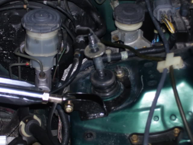

so I'm driving home from work along the dirt road, not on the main highway yet, and I hear this clunking noise coming from the drivers side in the engine bay. I'm thinking, "maybe it's just some rocks/mud kicking up inside that got caught in the fender well. Well the noise stayed there so I pulled over and popped the hood.

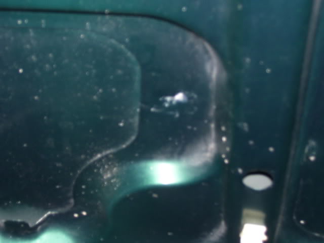

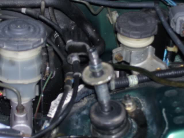

It couldn't be any more obvious what the problem was. The rod inside the strut blew out and was sitting about 3" higher than it should be. The top of the rod was denting the inside of the hood and there's a visible dent on the outside of the hood, it probably would've gone through had I tried to drive home all the way like this.
This new suspension setup is not even 2 months. KYB AGX's in front and rear, H&R Sport Springs all around.

You need the proper rubber bumpers on the strut rods or stuff will break when it bottoms out. Though this does look like the top mount bushing may have just failed.
