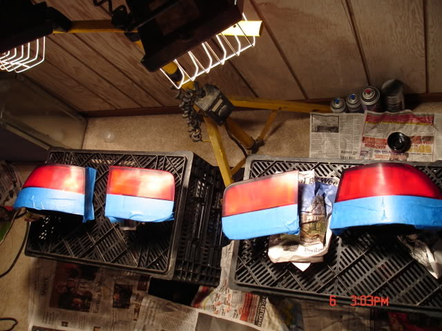

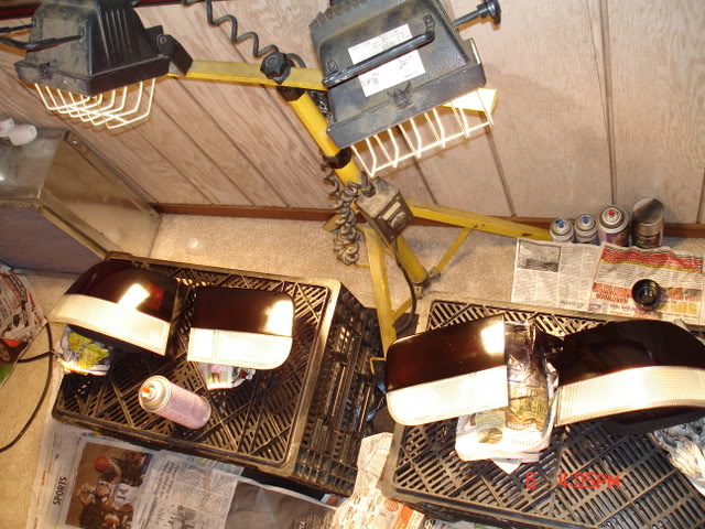

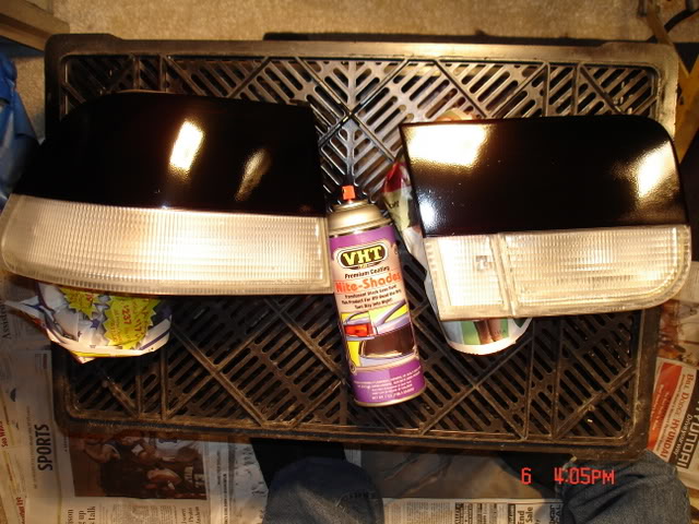

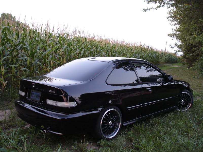

well i dont know about that much time between coats... i had mine off for about an hour. tho i did cheat... i used some halogen lights to heat up the taillights before tinting them so they would be nice and warm to quickly dry the paint. i think i waited like 5-10mins between coats just to be safe.
mine where shinny enough.... after you have them tinted for awhile just sand them with 2K grit sandpaper lightly and wax them back to a shine. the sanding and buffing will remove some of the orange peel leaving a slicker look. i never sanded mine because they looked good enough for me!
