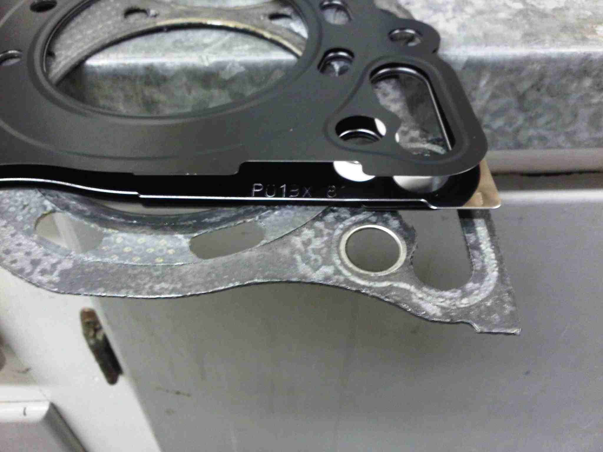

Default TSB 97-047 4th and 5th gen CIVICS (non-vtec)
Okay, attached is a picture of the recommended head gasket per the TSB. Note the bottom headgasket is a composite material whereas the upper is a metal sandwiched by another thinner metal on either side. Far better design. If you go to Honda they will sell you the old one! You have to request the new one 12251-P01-004. Don't install the old one! Mine blew in 15K miles.
