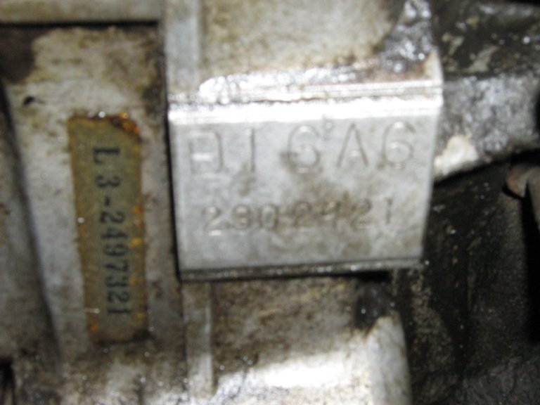

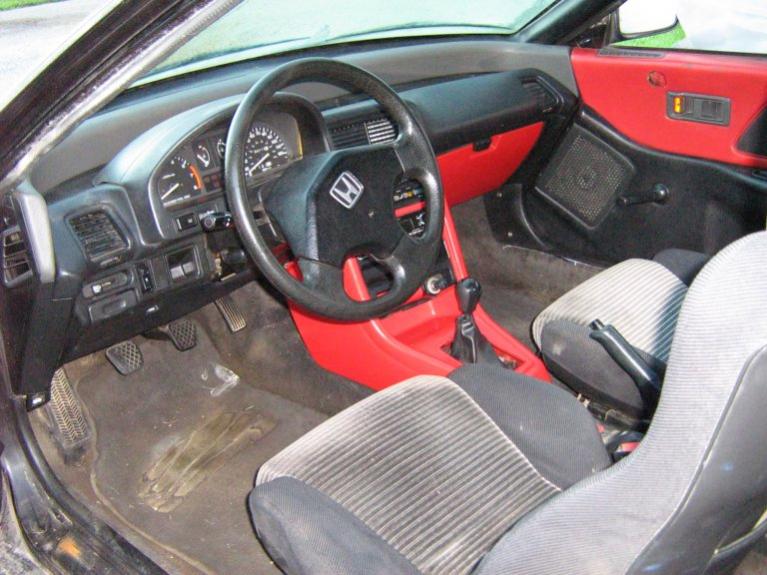

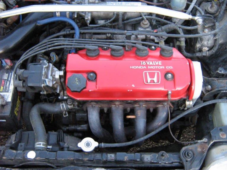

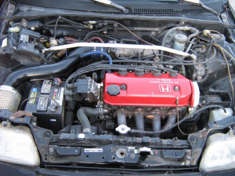

I'm going to check out a 1990 crx si($1000) later today or tomorrow. What should I be asking the owner about? I can figure out the basics(mileage, repairs, maintenance) but I need to know what I should be looking for. It looks ok from the few pics I have but they dont tell the whole story. I've been searching the interweb and the members here really seem to know their shizzit. I've been thru most of the threads and wasnt finding what I was looking for. So I call on you any help y'all can give me would greatly be appreciated. Sorry I dont have more info.

car looks pretty clean minus the painter interior.... but with any crx or older honda bring a jack to lift the rear end up so you can look under it clearer. hondas worst problem is rust! if the underbody rusts out to bad the car is just for PARTS!!!! also check the rear center brace..... that part is frequently rusted badly and needing to be replaced to be safe... otherwise you hit a bump to hard and the LCA mount will just bust loose from the unibody and really throw ya for a loop!!!
