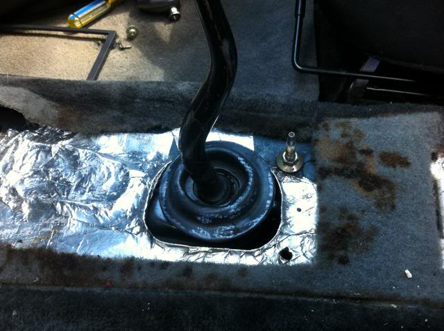

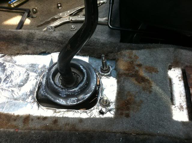

I also got around to installing my ES shifter bushings. The shift linkage was in shambles, so the install too me about 1.5 hours start to finish. I ended up dropping the exhaust by pulling them off the rubber hangers. Gave me enough room to work in there.
Previous:
Don't mind the tin foil ****. That should be replaced with something better sooner or later. not really a major concern of mine right now. Notice there is a missing bolt? Shifter and linkage was dumb loose.
After:

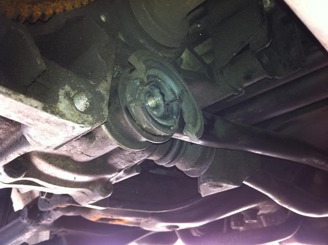

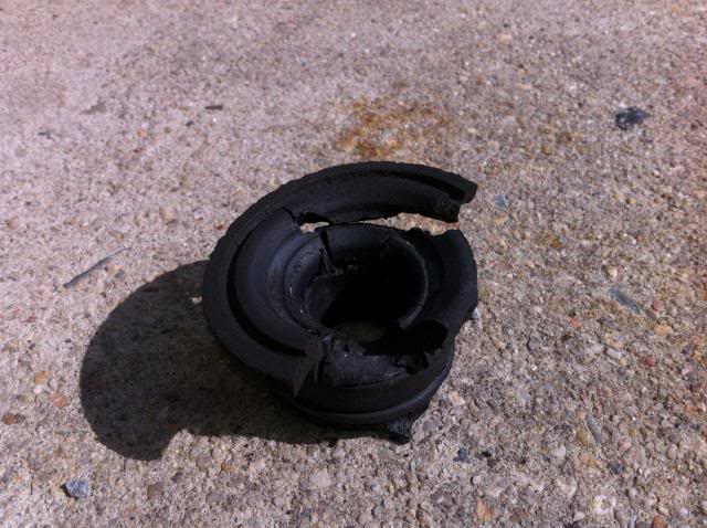

The one under the car looked fine, just missing bolt allowed the play. The "other" bushing near the trans was a different story...
Gross. No "after" pics since it now just looks like a normal bushing is in there like it should.
Previous:

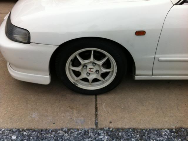

Thanks man. Unfortunately, it is already getting blotchy and yellowish, so I don't expect it to last. Glad I only did one wheel as a test. Going over them every month to re-white them would be a bitch. The white lettering is gonna be stripped off this weekend probably.

Pulled the white paint off the tire. Honestly, it was yellow and only had spots of white left. Maybe others who use pads which create less dust will have better results.

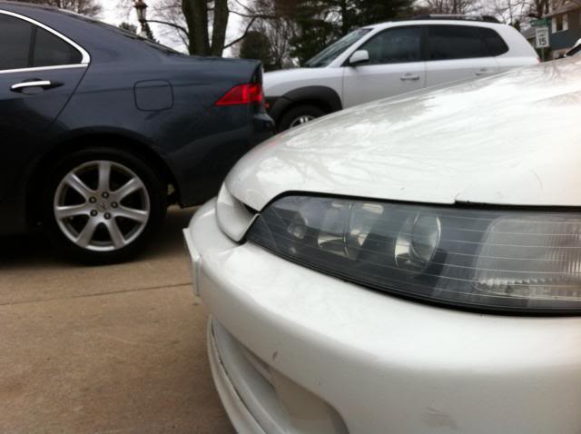

Took apart the front end and realigned the headlights. Dont mind the bumper sag. Pulled off the red "H" emblems. I have little painted-white plugs in the holes right now, but I need to start looking for a better alternative since I am not happy with the way they look.
