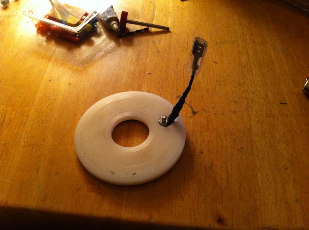

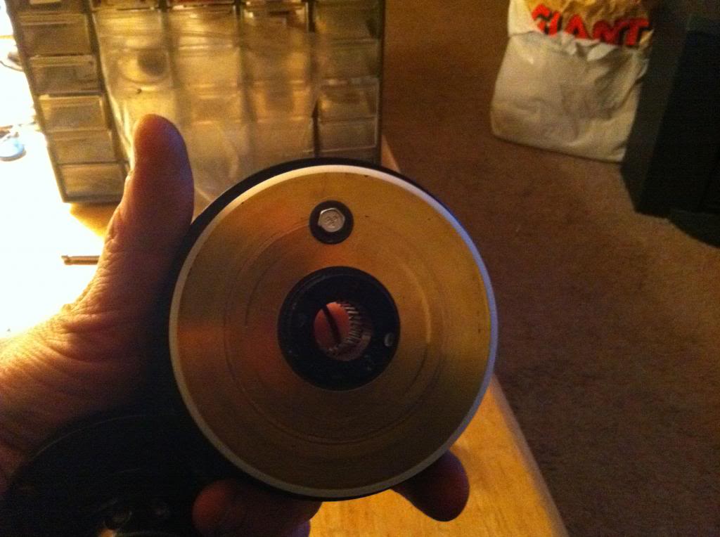

Pulled the hub off again tonight, fixed the horn wiring. Was a frail little elec connector soldered on. The plate was rubbing against the horn rig up piece and turning. The wires then being pulled and it broke. Should be good now...

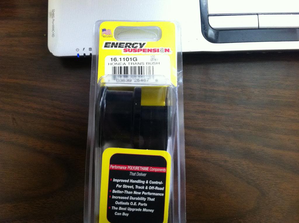

Picked up a set of ES shifter bushings at the local Pepboys. $15, but I had a $10 off rewards thingy, so $5

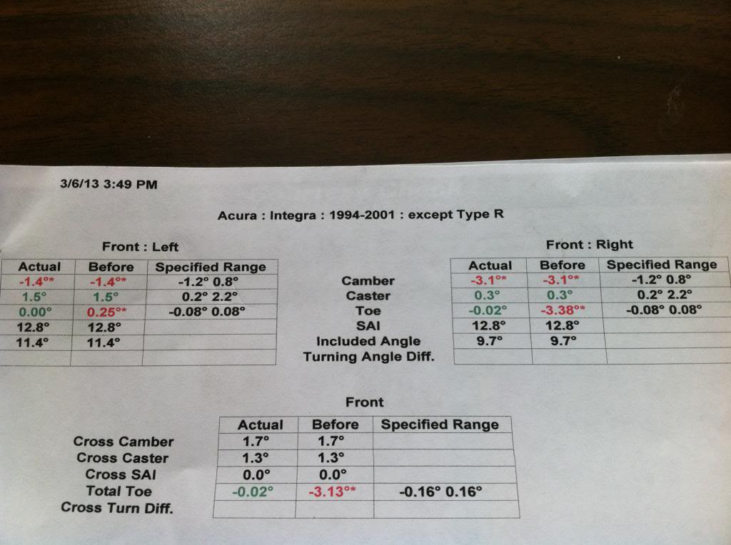

Pic of my alignment results. Yea, that toe on the right was TERRIBLE. I still need to play with the camber kits to get them how I want. Not sure if should be concerned with the front left caster or not :/
EDIT: Rear TA are needed badly now. Horrid clunking in the back driver side when I hit a bump. Tech at the alignment shop confirmed that they are shot to hell.
