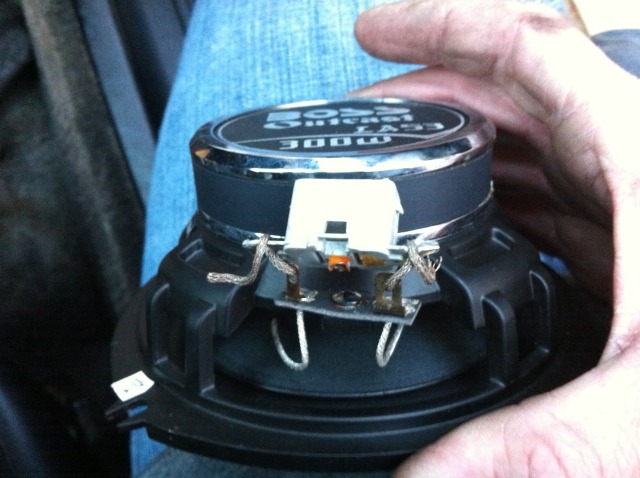

Shoddy front speaker wiring

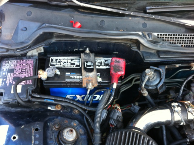

New battery!

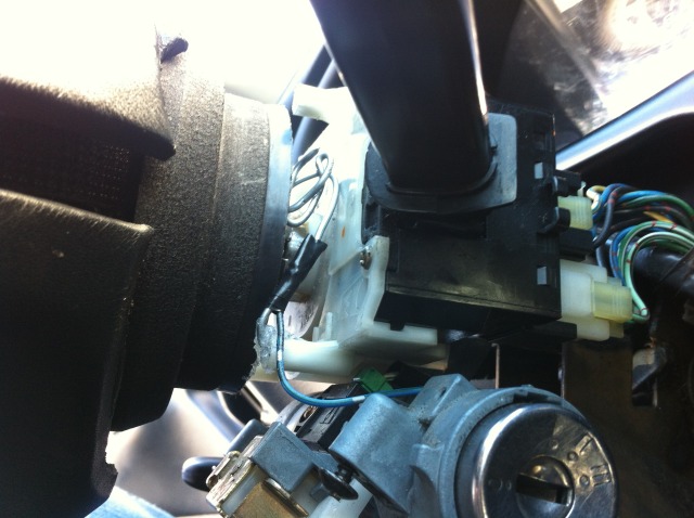

Had the day off from work did a bunch of boring work to the Integra. Oil pan gasket, more wire testing for this starting problem of mine, and I tried to get the clutch line to stop leaking (no luck - Emailing eBay seller tonight). Also got my horn working 100%!!
Found a bunch of videos on youtube and many people were saying using a paperclip and the hub will just rest against and just have the power wire from the harness attached to that. Boom! It works perfectly. I couldn't get my steering wheel off for some reason so I had to make due with the space I had available.

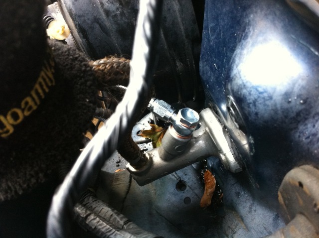

Leaking clutch line
New battery!

That's sodd with the banjo fitting on the slave. My stainless braided line threaded right in to my slave. Did you use some sort of crush washer on either side of the banjo bolt?
