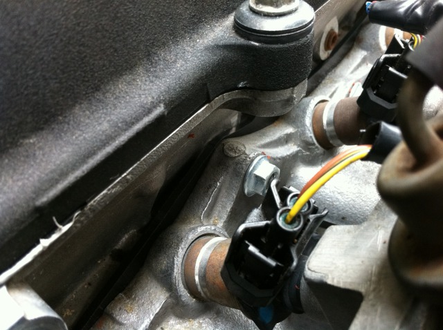

More wire testing this weekend for the starting issue. Received the replacement CMC a few days ago. That should be going in, too!
Blox IM gasket
More pics to come
