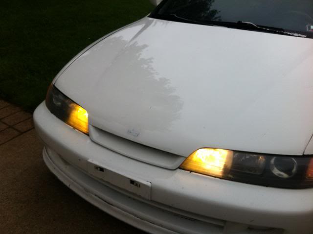

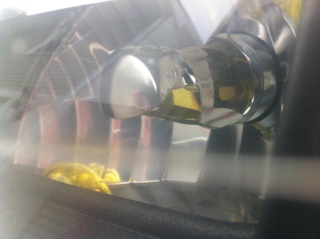

Found this the other day.. no happies about it.

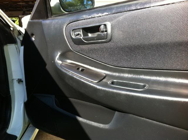

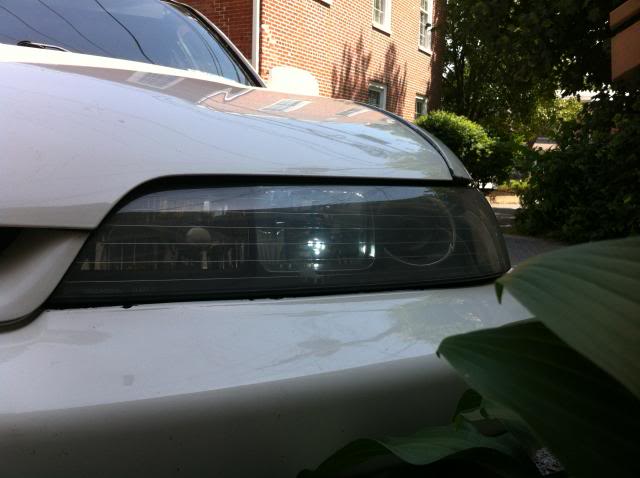

I need to pull apart the lens or replace the lights altogether. Finally got around to fixing the passenger side window switch. Plasti-dipped it since I didn't want to ruin the m44dd tight jdm-ness faux CF on it. Doesn't stand out from the rest of the door panel and matches very well with the rest of the interior.

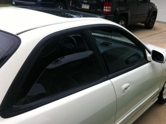

Painted the lower window trim on the passenger side, havent had time to pull the upper piece yet.

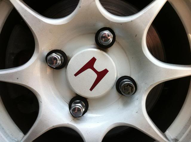

Installed some OEM wheel locks and the LED citi lights. I will try to get a night shot of them soon.

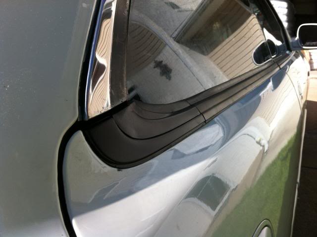

Finally finished painting the side moldings. Ended up painting the windshield wiper arms as well.

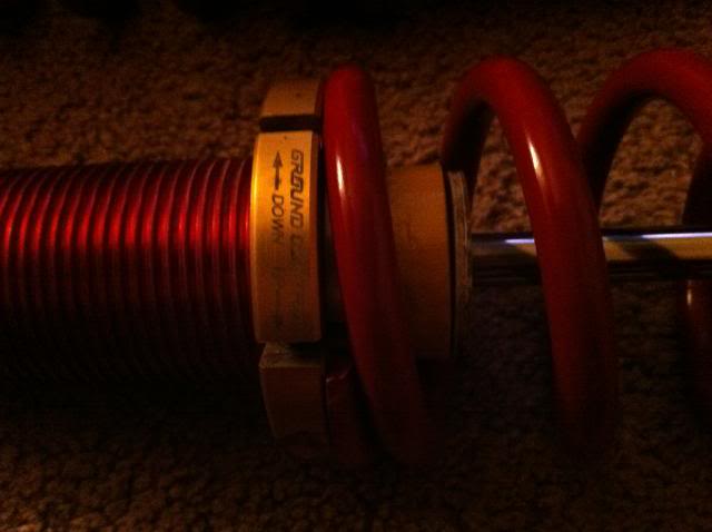

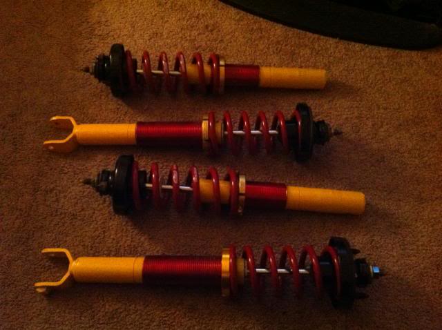

I picked up a set of use koni yellows/eibach springs/gc sleeves for a good price locally. Shouldn't have bought it, but driving with springs on stock struts is getting annoying. I just ordered Moog inner/outer tie rods with replacement bellows. My plan is to receive them this week and head over to a buddys house to have them installed over the weekend.

For the newer Civic you have, right? I have a set of H&R springs on stock struts if you have a GEH that I can sell ya
they are technically for a Integra hatch, so the *** end sits lower slightly.

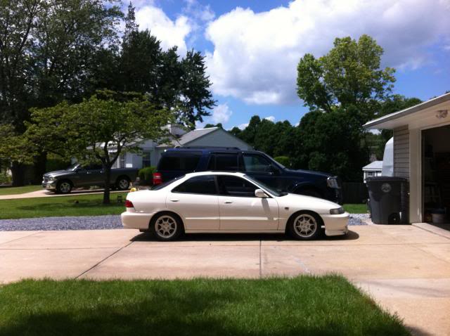

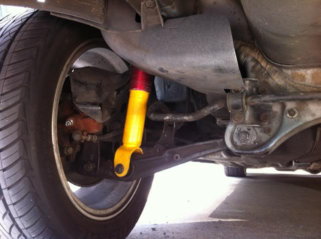

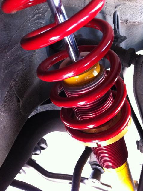

Suspension installed. Fronts couldn't have been easier. Some reason I was fighting with the rear driver side to get the lca line up and the bolts in. It was hot out, so the install took a little longer than expected. At least it didn't rain. East coast peoples are with me on that one
First installed. Straight monster truck status
Adjusted to where I want it for now. Planning on going lower once I make some extended top hats.
Always had a knocking noise in the back, but only over random bumps and thought my RTAs were shot. Alignment shop also said they needed to be replaced. Found out my OEM rear shocks were from a hatch, the extra weight in the back caused it to sag (reverse forked lol), that along with the lowering H&R springs forced the back of the car to hit the bump stops. The stops on the OE shocks I pulled from the car today were in pieces. haha So far, so good with the new set-up. Feels great to drive a properly lowered car again.
