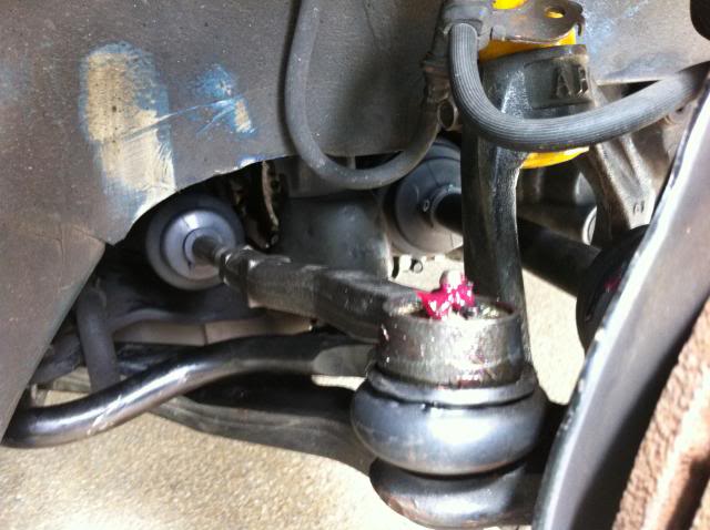

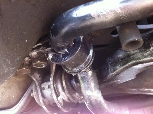

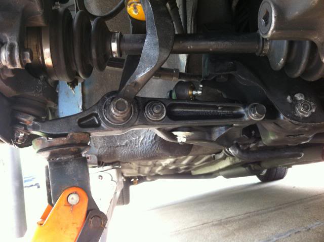

Front lower control arms replaced along with front sway bar endlinks and sway bar bushings (ES). Car rides much better now.
New vs. old. The bushings were shot needless to say.
Moog tie rods
Moog sway bar endlinks, Dorman control arms
Energy Suspension front sway bar bushings
Moog tie rods

There is a knocking/clunking noise coming from the passenger side all of sudden. Any suggestions?
Passenger side FLCA/sway link/bushing was done 7/14, no problems. Driver side was done 7/21. Noises started shortly afterwards. Did I **** something up while doing the driver side, or is there a possibility Dorman makes ****hole control arms and that they are failing already? I have not gotten under the car to check everything out yet. Hoping on doing that tonight.
No noises on the driver side at all. No clicking during turns, no feeling of this clunk in the steering wheel. All tie rods replaced 3 weeks ago, koni yellows/GC installed 1 month ago. When I slalom the car, I hear it every time I have the car turning left. There is also a plastic knocking noise and it sounds like that is coming from the inside the car. Not really worried about that though.

I would double check all those bolts. I just did a complete suspension rebuild and found I had not fully torqued the sway mount bolts causing the cover plate to loosen and clunk over sharp bumps. Luckily no damage.
If it's a sharp knocking, double check the torque on the sway bar links, they have a habit of needing a tightening after a few miles after initially installing them.
BTW, did you have any squeaking problems with your konis? I got oranges and the rears squeak like crazy until I apply silicone grease to the shock rods.

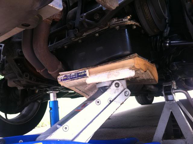

Haynes manual being used appropriately... again

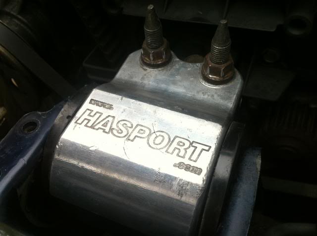

Hasport engine mount installed

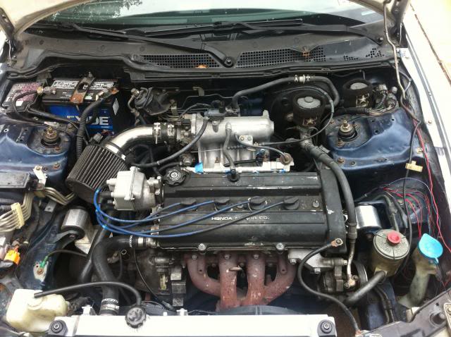

Engine bay shot - In mid tuck on driver side, don't mind the exposed wires.

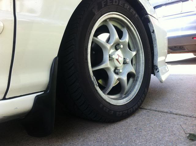

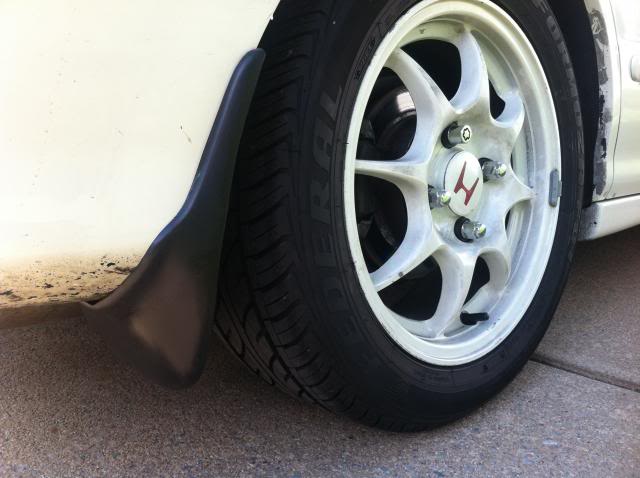

Mud flaps!
A part of me wants to paint the exterior white so they match the car. Thoughts?

Mud flaps!

Mud flaps!
http://i279.photobucket.com/albums/k...pse7d78b5e.jpg
http://i279.photobucket.com/albums/k...ps0490f00c.jpg
http://i279.photobucket.com/albums/k...ps69e7a7b3.jpg

Looks good man! as for the mudflaps, i like the black. gives it a little bit of contrast.
^^Sticking with black. If they were painted, they would start to chip and look like crap quickly. The mud flaps are more flexible than I thought, so the paint would just crack and break off. They scrape the ground when pulling into my son's daycare, but no where else so far. lol

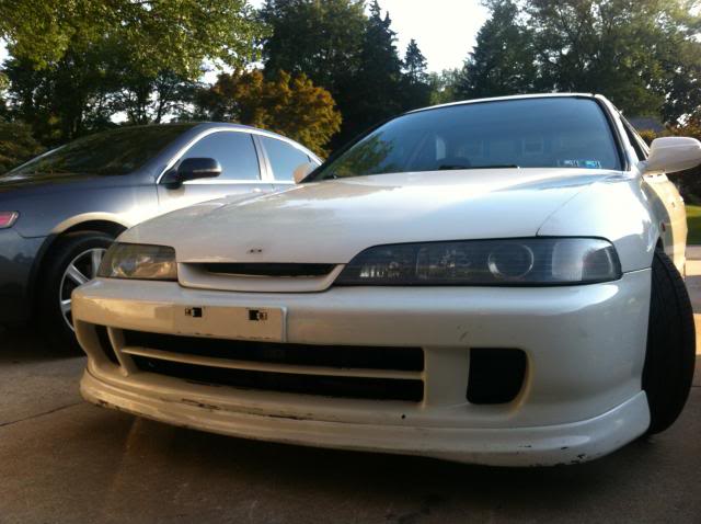

Planning on finally painting the front and rear bumper "insert piece thingys" Basically, the bumpers are painted all white, and they should have black in them. I will post pics when I am done. Hoping to finish the driver side tucking this weekend too.

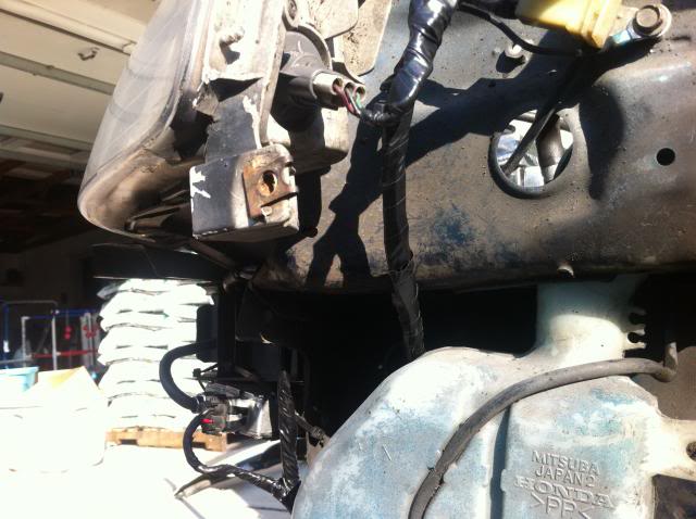

Spent about 8 hours working on the car yesterday. Driver side tuck finished. I plan on buying some sleeving to make it look all pretty, so that should be done in the next month or so.

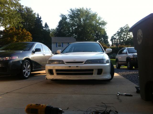

Front bumper inserts/grill painted
No pics of the rear, but this is how the bumper should look for the jdm front. It was all white before.
Doesn't look like much, but wiring took over 5 hours to finish. I am super paranoid I will mess something up, so go as slow a possible. car was washed yesterday, too.
Yes! Wire tuck! It's one of the most fun things to do! Not to mention that NOBODY NOTICES.
I've gotten ZERO compliments on mine. :'(
The bay is way easier to work on with all the wiring out of the way. It's definitely a mod for YOU, the owner! Yours looks to be coming along nicely!
