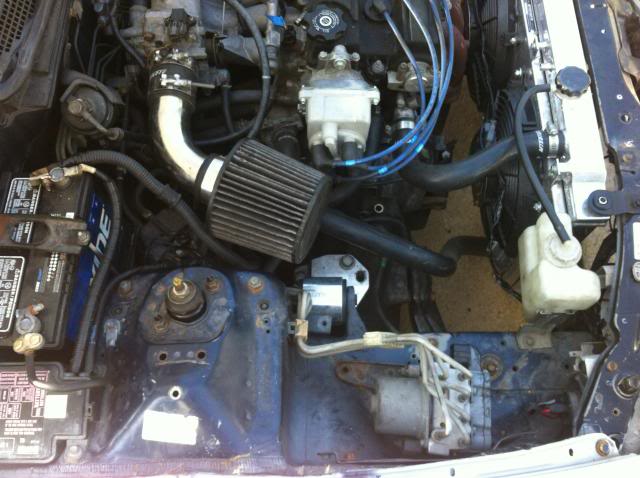

Looks like I need front brake lines, and a prop valve from a 92-00 Civic with rear discs, but no ABS (99-00 Civic SI), or from a 94-95 RS Integra. The big huge box with the 20 hard lines going to it should be removed after that. All wiring has been unplugged in addition to the entire ABS fuse box being removed with no problems.

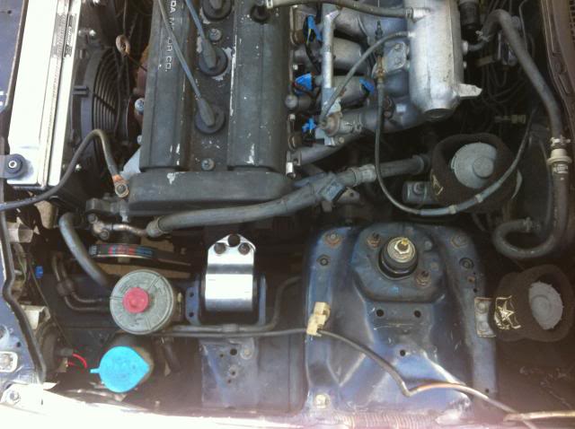

Pic of the driver side

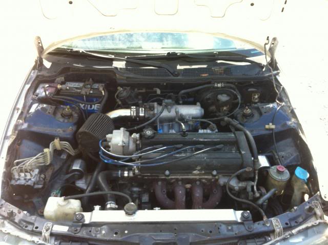

Updated engine bay pic

Yea, it will get pulled sooner or later. Once I find the correct prop valve, I am golden.

The tuck is looking good. Tap the fitting around on the back of the intake manifold (brake booster) so that it points down. Use a rubber mallet. Then route the brake booster line under your MC. It'll clean it up just a little bit hey?
Custom line for power steering + pump relocation? You could put it down low so it isn't popping out at you when you pop the hood!
I had good luck with using a spare harness and chopping it up. Remember, its a circle harness, so the driver side shock tower plugs should be relocated... or you can just make a subharness from the passenger side to the driver side for those 2 plugs. That is, if you want the harness to all come from one spot on the firewall, so you can put in a quick disconnect later on.
