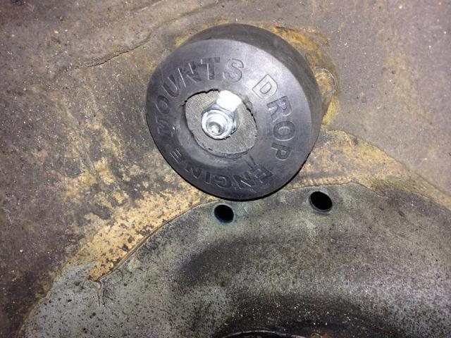

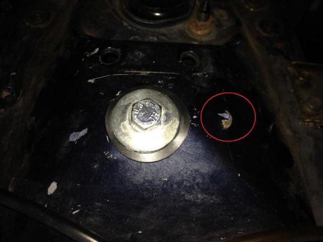

Apparently I am too mad JDM with the camber kits up front. Top side of the upper ball joints hitting the strut towers.
My solution...

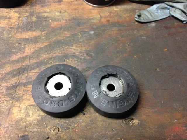

aftermarket engine mount pucks drilled out with a bolt holding them in place.

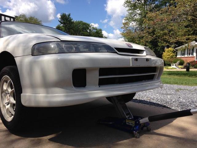

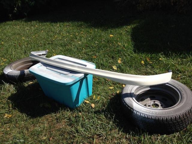

Also ended up painting my lip. Found a good color match to champ white.

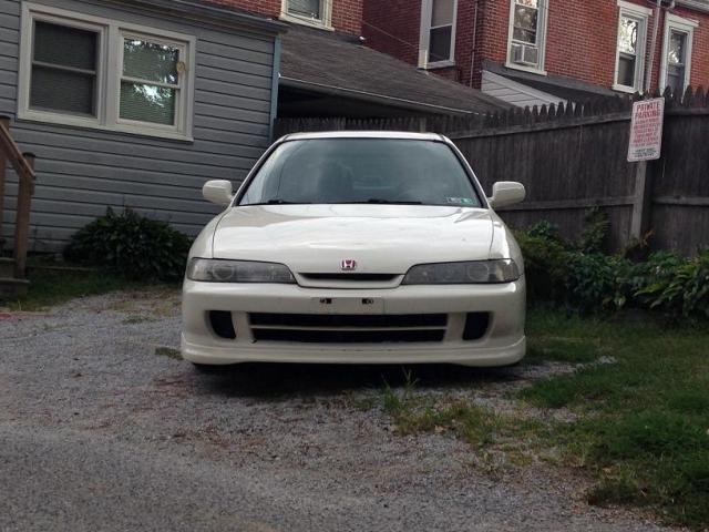

Now the bumper looks like **** IMO
