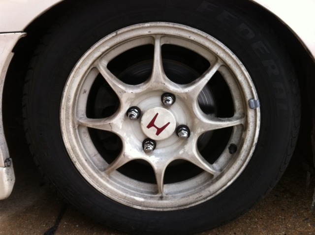

OEM lugs nuts

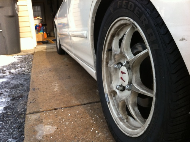

Gross wheels

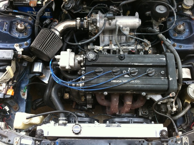

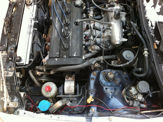

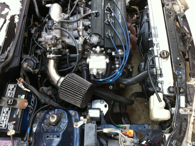

Updated engine bay shots. Dont mind the random red wire. I was using it for the fog light testing.

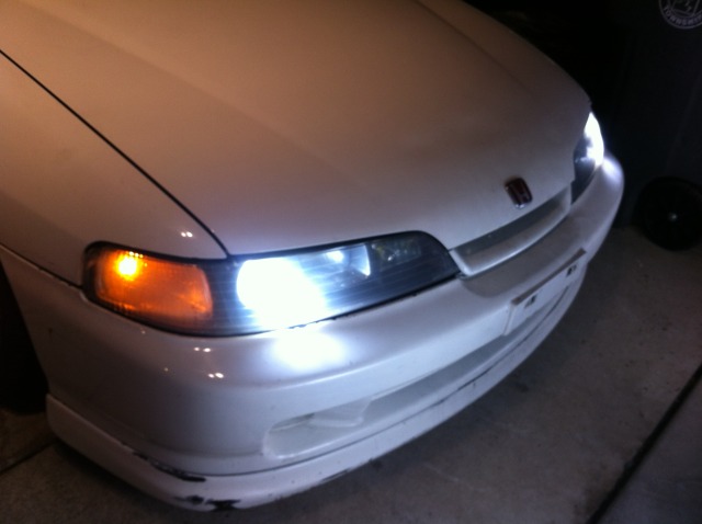

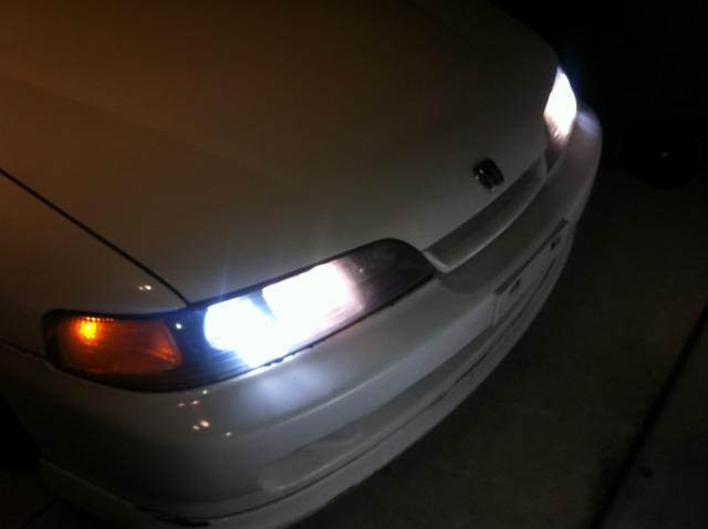

6k HIDs. Might not look too different in pics, but it is MUCH better than the previous bulbs.

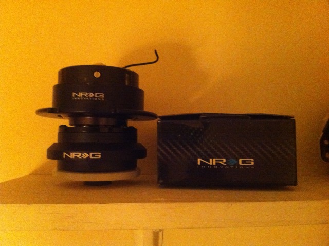

Sweeeeeeeeet NRG good-ness (short hub and gen 2.5 QR)
OEM lugs nuts
Gross wheels

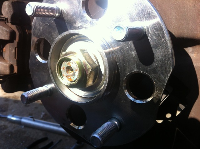

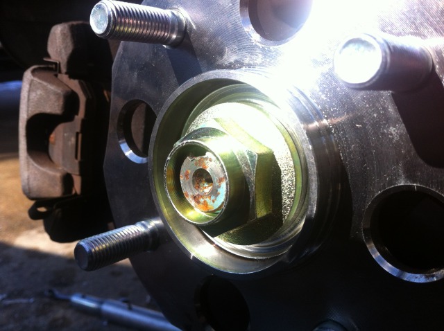

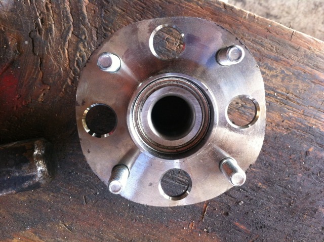

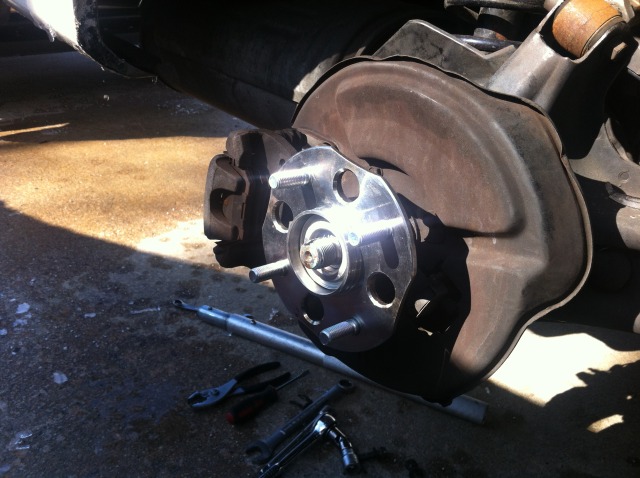

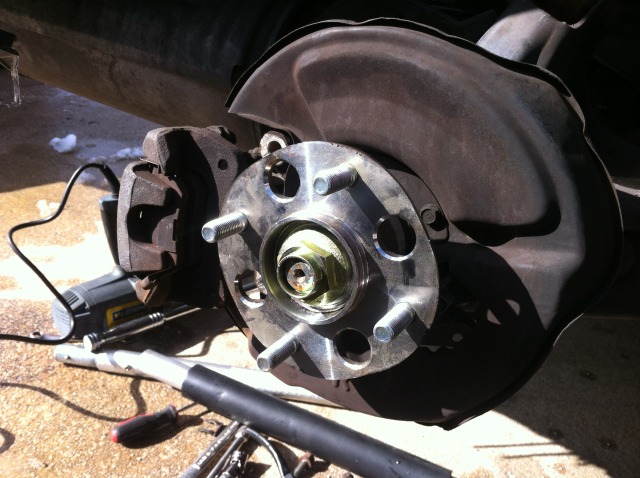

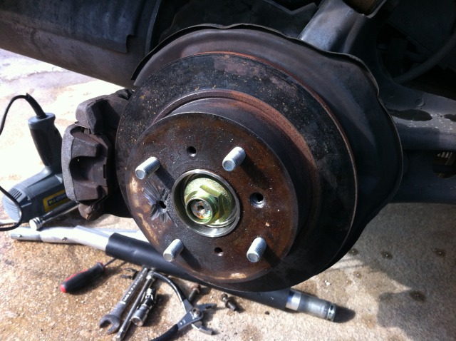

In other boring news, I was able to successfully swap out the rear assembly from an 98-02 Accord. Swap took me about 2.5 hours for one side. I used an angle grinder to shave down the hubs. Not sure how long they will last, but we will have to see.

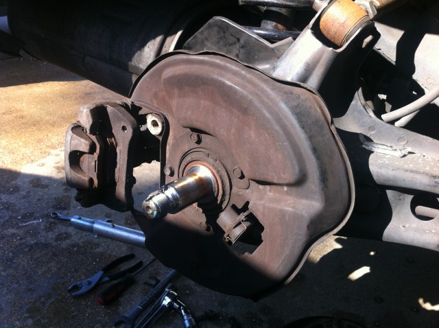

Empty spindle:
Accord hub tested on spindle:

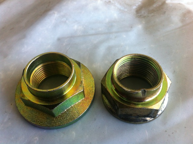

Axle nut comparison. Basically the same, but the Protege axle nut just has less threads on it. OEM on the right:
OEM axle nut on Accord hub:
Protege axle nut on Accord hub:

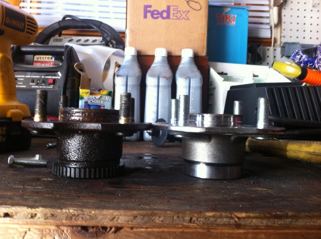

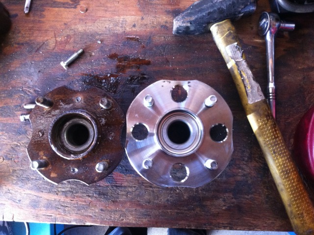

Hub comparison:
After about 2 hours of grinding - I used my rotor to "test" if the hub was at the correct size.
Back on the car after grinding:
Rotor on (don't mind the digs it in - stupid screws in the rotors were stuck):
The only thing is that there is no hole for the screws to keep the rotor in place. Good riddance is what I say. I hate those things. Drove the car around on the highway and no problems. Still have to do the other side.
Empty spindle:

Hub comparison:
