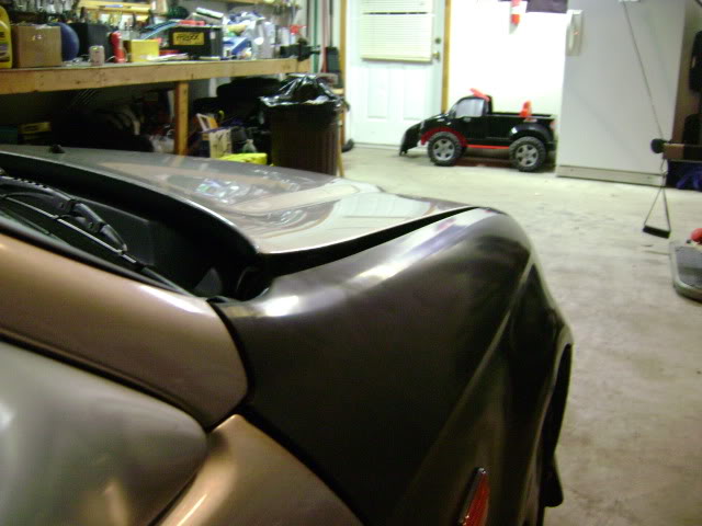

After 4 hours of work, the last big wire loom has been hidden away. I have it snaked through the fender well (at the top so it wouldn't be touched when I turn the wheel). Here's an updated pic:

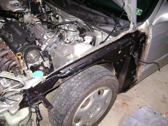

Tonight, the plan is to take off the driver fender, sand down the corners where it meets the door and spray it with a little rustoleum black. When I was doing the wire tuck, the fender fell (somehow) and nicked up the corner. A little brown is starting, so I will stop it before it becomes an issue. 94chb was asking for some shots of how I snake the wire through the fender well, so I'll post some tonight. I am also thinking about buying some of the rubberized spray coating to spray the fender wells with. Trying to simply make it look cleaner and what not.

^^ Here ya go 94chb...... I also ended up painting the fender wells with rubberized undercoat spray.
