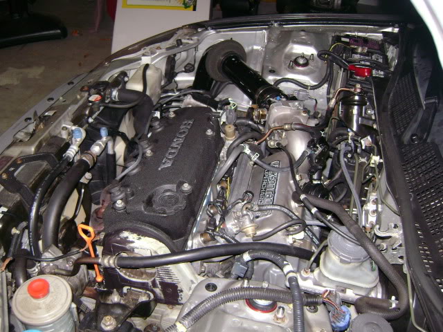

Two quick pics of what my bay looks like at the moment:
Just got done putting a fresh 3.5 quarts of oil in it and letting her warm up now. I will be taking her out for a test run to see if I loose any oil. I'll update about the oil situation later tonight. BTW, thank you addiction for the bypass and dryflow filters, spark plug seals, bumper plugs, and the fuel pressure gauge!

When I do get a header, the header and intake piping will be wrapped in exhaust heat wrap in order to attempt to reduce intake temps. That's why I didn't care about how the paint looked. However, I will not end up buying that stuff until I get new injectors first.
