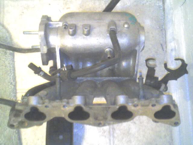

Here's the bare y8 intake manifold I was able to grab. Got a lot of missing stuff and hoses to nowhere. Still wondering if a z6 throttle body will work with it. It needs a good vatting.

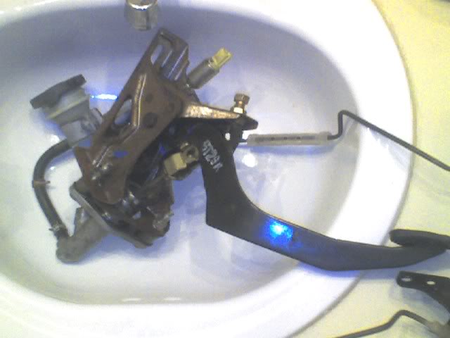

And here's the clutch pedal attached to the MC and reservoir and hard lines etc. What is the best way to clean such a thing? The fluid I pumped out was black like oil.

Its just sitting in the sink because I lack anywhere else to put it.

well dont worry about cleaning the inside of the fluid lines.... when you bleed the fluid it will flush everything out. so at the most just put some water thru the lines to flush any big debri at most.
but if you wanna clean the outside of the parts.... brake cleaner and a rag works wonders!!!!!!!

The intake manifold is gonna take awhile. The z6 throttle body fits but who knows if it'll work. The y7 fuel rail just seems different. The z6 TB is from a manual. My spare y7 TB is from an auto.

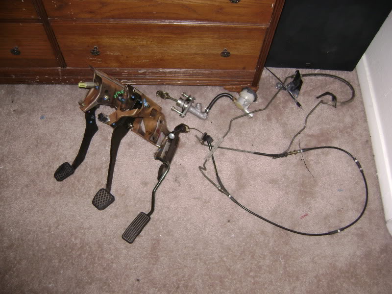

Also, more junkyard fun.
Got the other two pedals and a y8 throttle cable if needed. Now all I need is to test the MC, get a SC, and get a transmission. Hydraulics covered.
I still need the flywheel, clutch, pressure plate, flywheel bolts (tried today, ****ers wont move), and the tranny mounts. But the parts are coming together faster for the 5 speed swap.

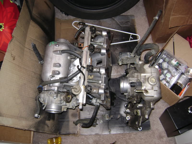

Also, got the fuel rail and injectors swapped over from the y7 mani onto the y8. Its just for the fitment. I've still gotta get some 450cc injectors for the setup.
