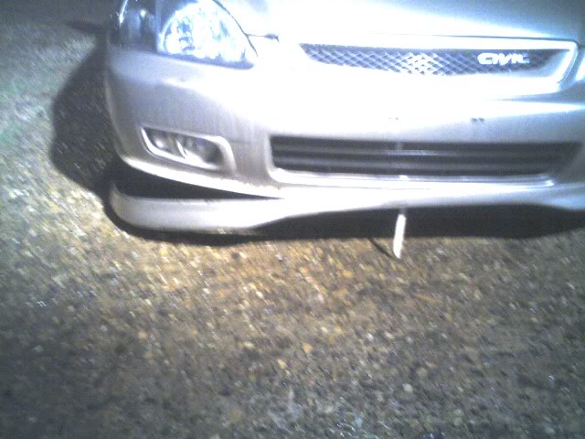

Well ****. We had some sudden heavy rains. I couldn't see ANYTHING. I drove right into 2 feet of water. Couldn't see it coming. Had no warning. It ripped my front lip halfway off.
I went ahead and pulled it completely off, but the 3M tape isn't coming off at all. The lip is broken on the passenger side. It'll never go back on unless I get some awesome glue or fiberglass it. The paint got trashed pretty bad too. So yeah, that lip is pretty much toast.
That's not the worst of it. I think I got some water in the engine. It wasn't idling right at all. When I drove home, the car was bogged down until about 4K rpms. The whole car shook a little and the engine resonated strangely through the exhaust. I could hear and feel that the car isn't running right. I don't know where to start. Im worried most about the engine. I've gotta keep the car running for another year. Worst case, there's a guy with a 1997 LS swap for $700, engine and tranny only. I'd have to get axles, mounts, and a few other parts to make it work, then pay to have it installed because I have nowhere to work. Not the best outlook.
I fixed the bulb in my CEL so I can now tell that my CEL isn't on. Whatever the problem is, I'm not getting an error code.
As a last ditch effort I did an Italian Tune to see if the problem was in the cylinders. I drove about a mile and a half in 2nd gear at 60mph. Car still bogs down in the low RPMs at low speeds. Seems to be better at high speeds. Also, my brakes seemed weaker somehow. Dunno if that's connected. Any ideas? I really hope my engine didn't drown. I can't afford an engine swap with all these medical bills piling up.

I think your air filter is just damp. I got mine wet a year or two ago (from having no fender liners) and it bogged down until it finally stopped raining and the filter had time to dry out. To test this, take your filter off (just for testing purposes) and see if it idles properly and such.
