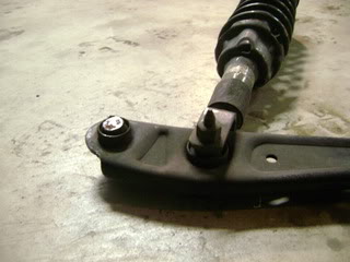

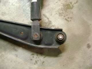

Yes. So basically, you will be left with a bolt sitting in there, sticking out the backside (opposite from where the bolt head is). You'll have to heat the bushing, then slowly turn it out from the backside.
On the other hand, you could be lucky and have none seize. You won't know until you actually do it. Im going to get my oem LCA that's in my shed and take a picture of what I am talking about. The strut is still on it since the bolt seized. I didn't care since I had new LCAs/bolts/coilovers to install. I actually kinda forgot about it until now actually. Going to install my tail lights now and take a picture of the LCA bolt for ya.

I'm not trying to scare you out of doing it, just making sure you are prepared for the worst. This is why I had replacement LCAs and bolts.

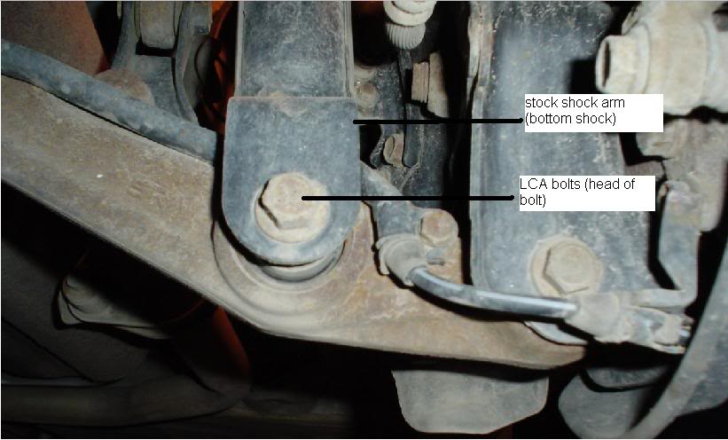

With the LCA, I'm hoping that the bolt will get seized on the nut then.
I'm not sure what you mean by this. It's a bolt that looks like this:
If the bolt seizes, the bolt head will snap off...that's it. You have to heat it up from the other side, and once it is a orangey-red color, take a wrench and slowly turn it out from the opposite side.
