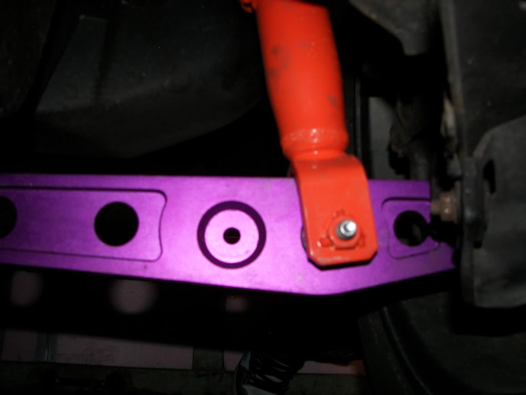

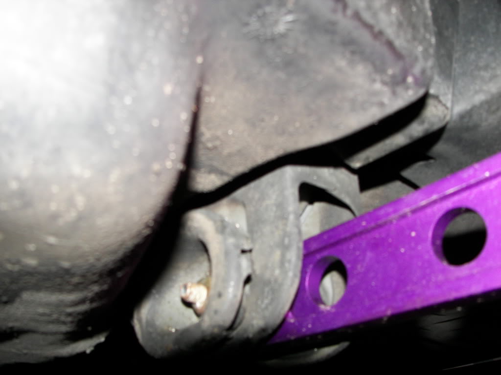

I just put in some new blox LCA's this weekend. I used m10x80 bolts from the hardware store, 8.8 grade. I think 10x70 may be a little short. However I was curious myself so I just went and took some pictures haha. Here's what 10x80 looks like-
So I dunno, its your call. Just make sure the thread pitch is 1.25 mm. I ordered my bolts from McMaster Carr. 10 bolts for 7 bucks.
Also, I only broke one bolt on my old LCA's, which endured 13 chicago winters. My suggestion to make it as easy as possibly is spray the crap out of it with PB blaster and hit the nuts with some sort of torch. Worked like a charm for me.
