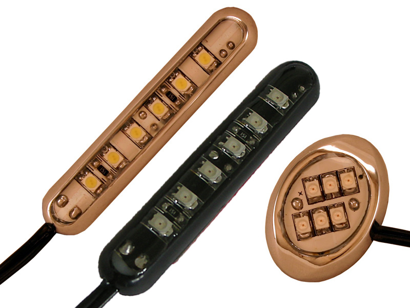

since I fixed my cluster I decided I would re-do the lighting with plug n' play bulbs, and I re-did the climate control because the blue that was in it didn't match my new cluster bulbs.
SO, I decided to go with white, so that the temp slider's red wouldn't look purple.
here's what it looked like before today:
I was browsing oznium and I found this for $10. (the black skinny one)
It's a couple inches long and has double sided tape on the back. It has 6 110º viewing angle LEDs on it, and It fit PERFECTLY in the area where the two stock bulbs are (about the same as on an EG civic). I was worried it would be too bright, but it's actually perfect. The pictures really don't do it justice, it's a nice even glow and it looks 100X better in person. In person it doesn't overpower the red/blue temp display like it does in the picture.
The blue LEDs in the cluster and from superbrightleds.com, and they are the T-1.5 HP bulbs.
