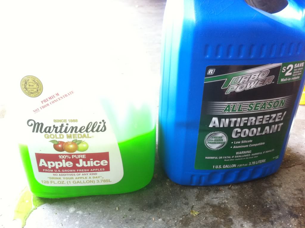

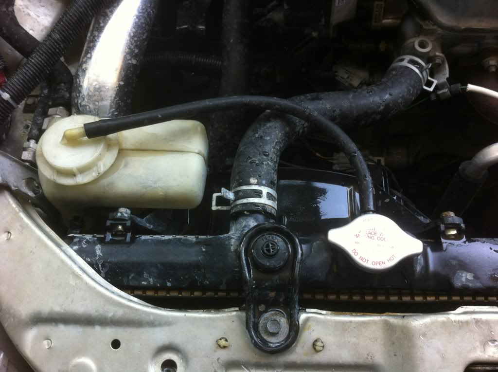

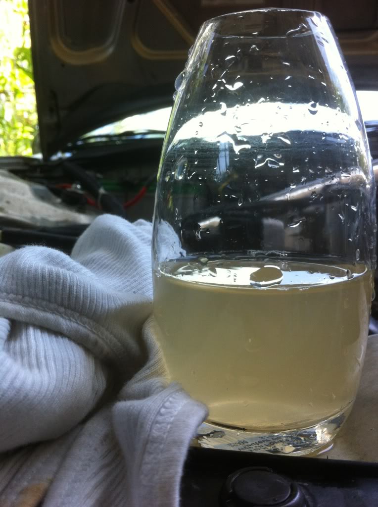

did a coolant flush today, seeing as hose water has been in there while i was dealing with all the over heating problems which have not occurred in a while now. The water is very rust colored, looks pretty bad... I did 5 flushes yesterday and then did 6 more today and it is still rusty water, I tihnk the problem is that the water never cycles while im running it with heater one. Not once did I see the fan come on, in fact I do not think ive ever seen it go on unless i jump it yet I do not over heat when sitting still anymore so I assume it is working...
this is the 4th flush, mid flush:

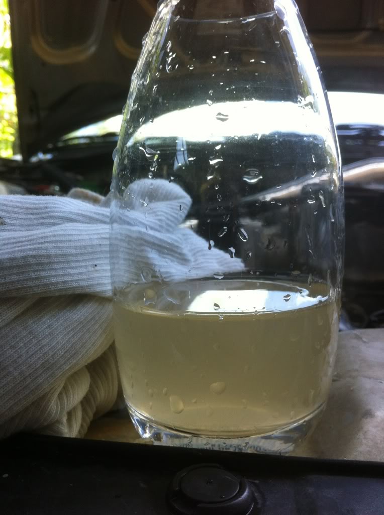

5th flush, last few drops:

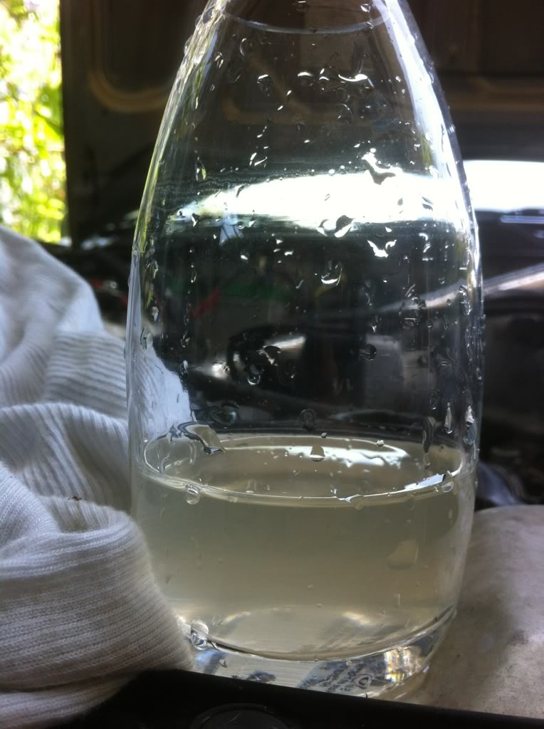

6th flush, last few drops:
I followed the DIY in the DIY section (do not know what I would do without it haha) but at this point I figured more and more flushing is just wasting my gas which is just too expensive right now. Note that the water is pretty clear till those last few drops that are murky as hell. I cannot find much info about the full extent of possible damage that would cause this but I assume worst case is rusted radiator and rust in the engine. Not that I would be in anyway happy about this but at least it would push me to actually get the engine rebuilt sooner rather than later >_>...
Anyway at this point i decided to just throw the coolant in there. Split the fluid .55/.45 gal and made the .45 half water.
So that is that, I guess, for now... I will have to see what happens with the rust, I will probably check the coolant color once in a while and as always keep a close eye on my temp gauge (which has stayed right at the bottom of the flag thing since i replaced everything).

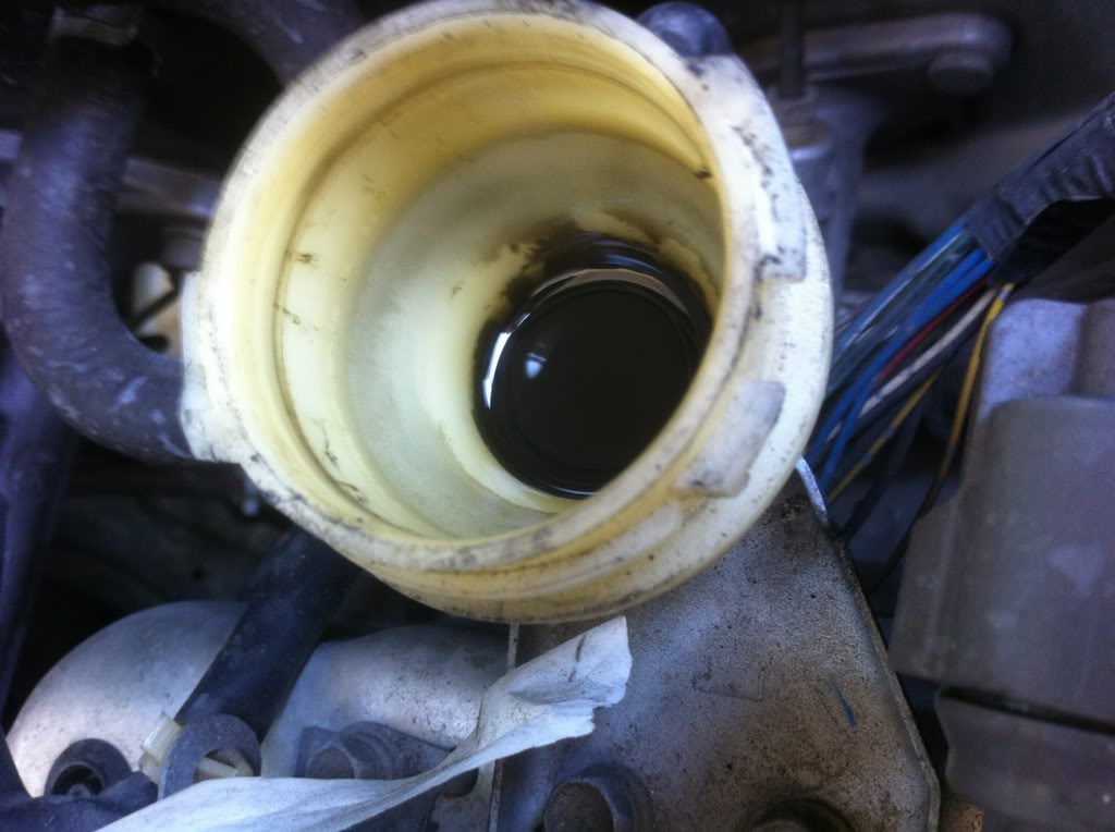

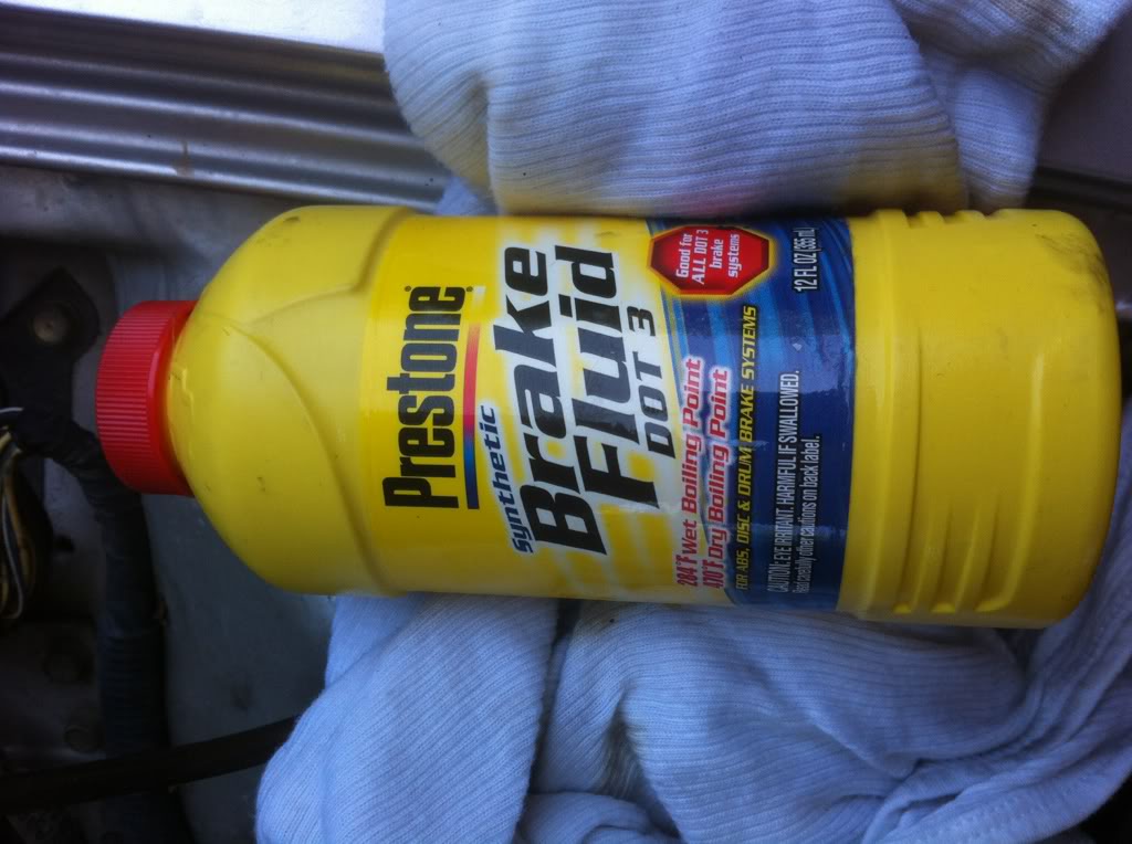

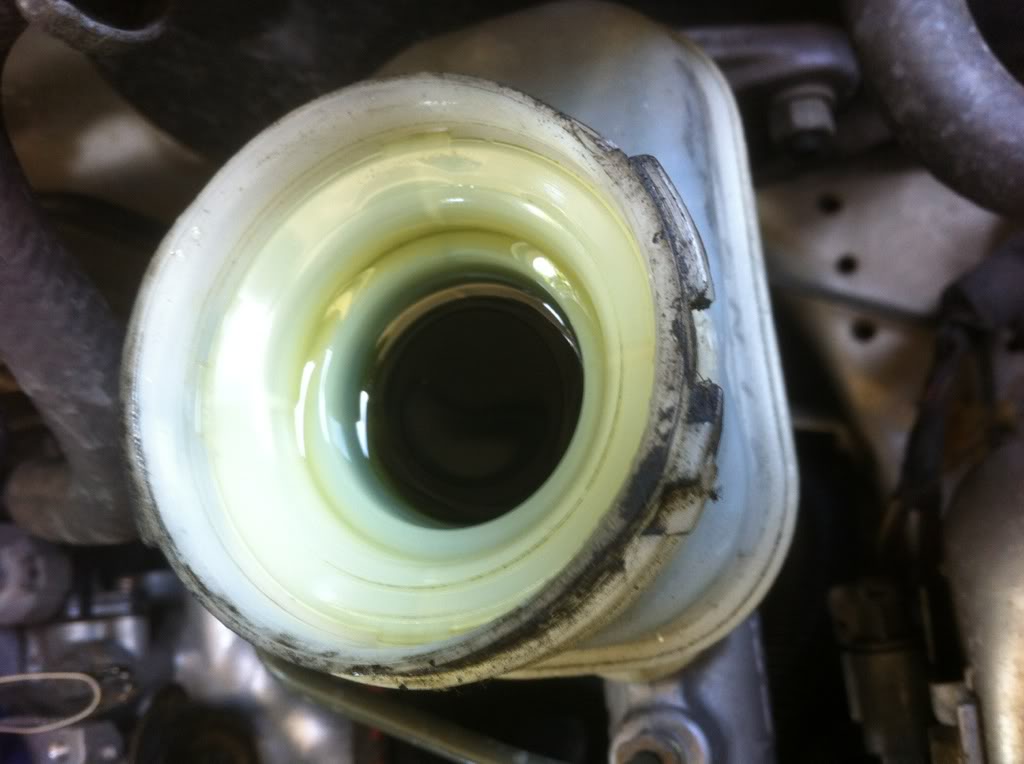

Took a look at my brake fluid since I want to swap that next, it is black and the new stuff is clear. this is probably a good sign i need to change it? haha... But since I will need someone to help me with this, it is going on hold till for a couple more days, also need to get a turkey baster and more brake fluid.
Probably wont update the actual brake bleeding, maybe just a picture of it not being black anymore haha.

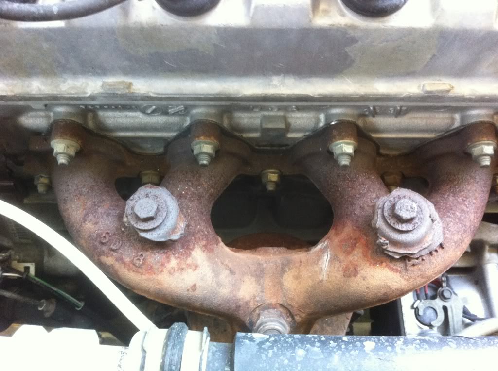

Then I remember seeing nasty rusted bolts on my header and refused to look at it while working in there because I did not want to think about taking those off... but huge relief, the rusted bolts look like where someone ripped off the heat shield haha... yea, dont even wanna know how that came about. But all the other bolts look like it will be fairly easy, I remember being worked about LCA bolts and they popped off like a walk in the park.

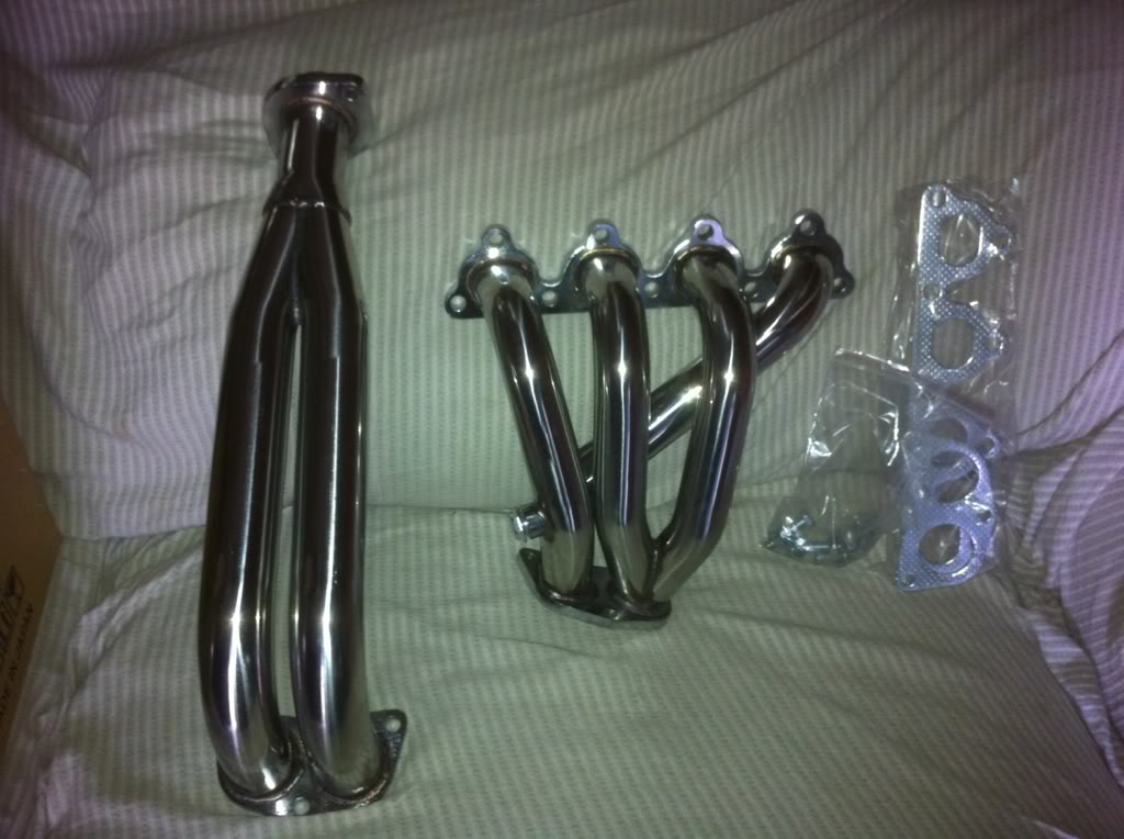

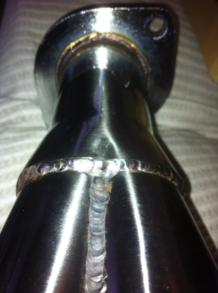

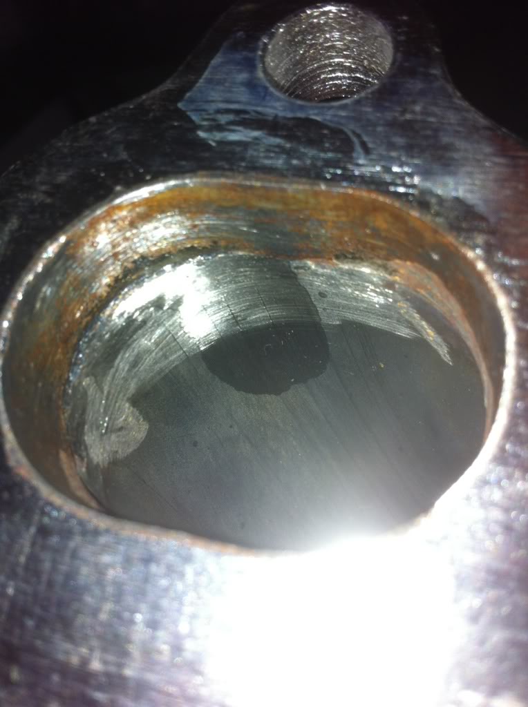

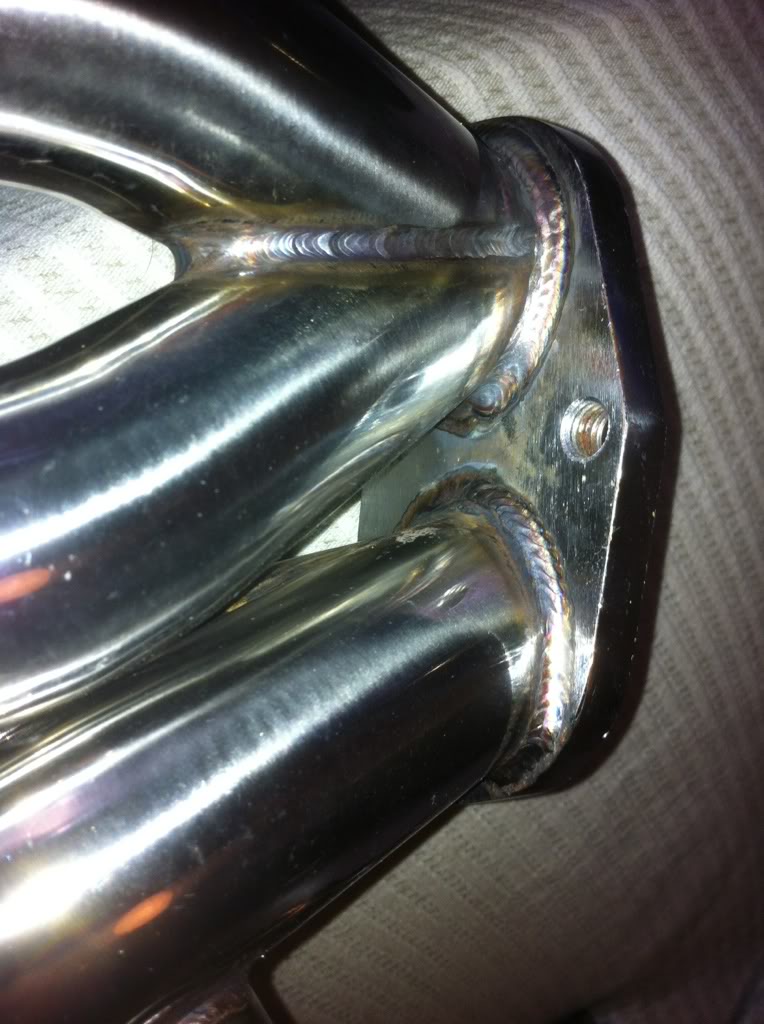

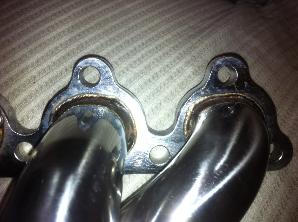

M2 Performance (Megan) 4-2-1 Header (2 pc)

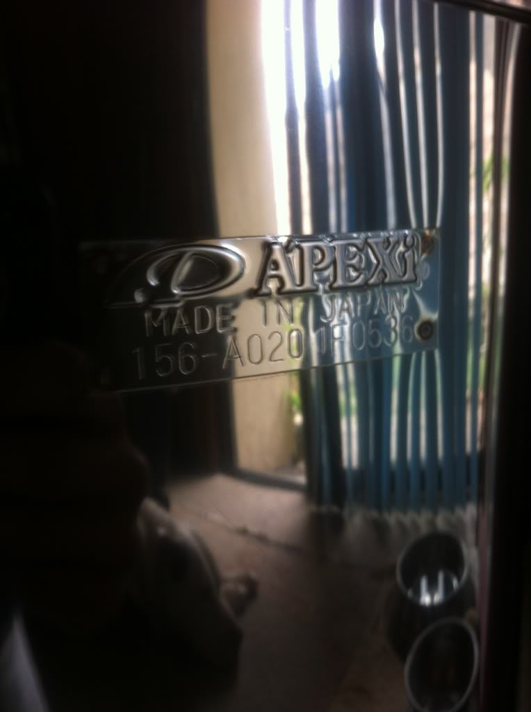

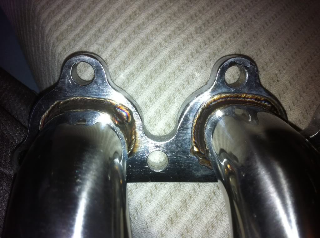

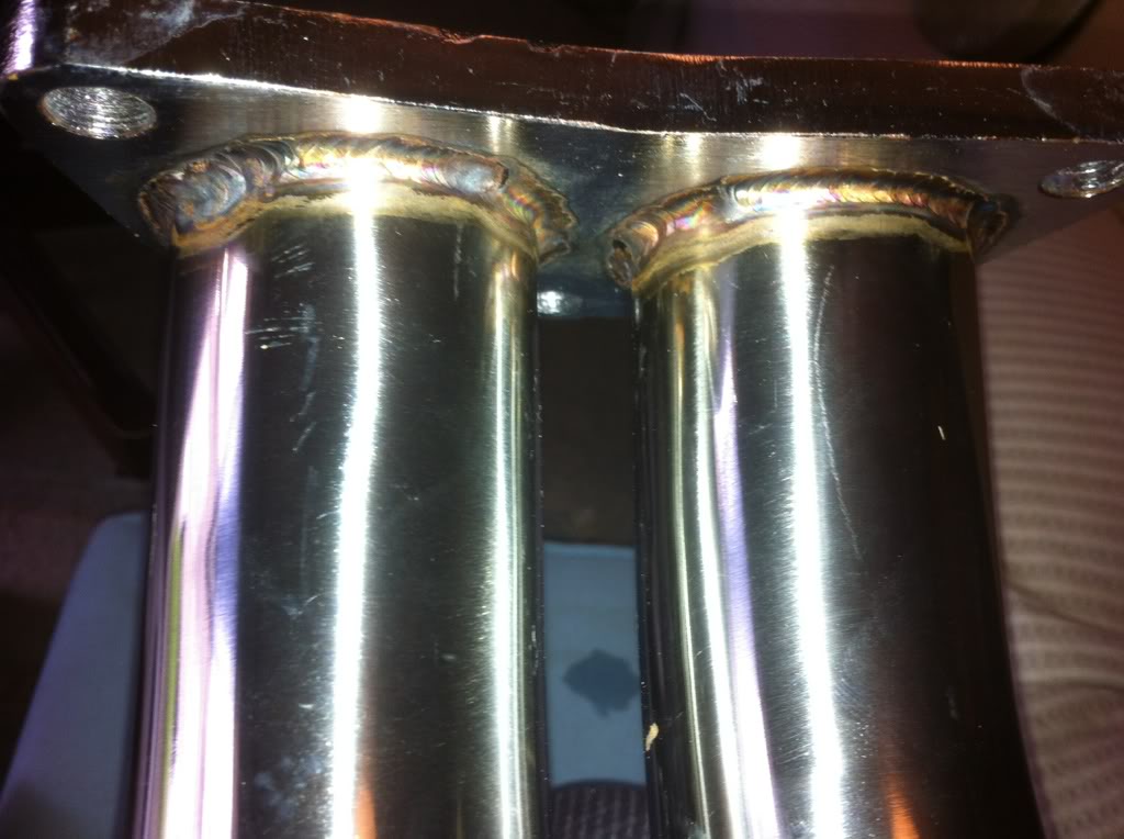

I know nothing about welding, but I tihnk it all looks okay. When compared to the Apex'i welds though it is obvious the M2 could be better.

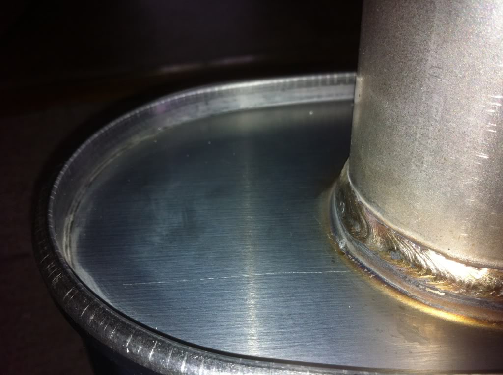

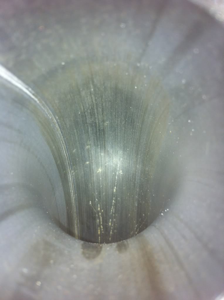

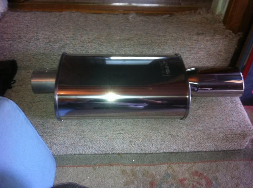

Apex'i WS2 (70mm)
This thing is a work of art haha. I keep looking at it, then at my stock muffler...

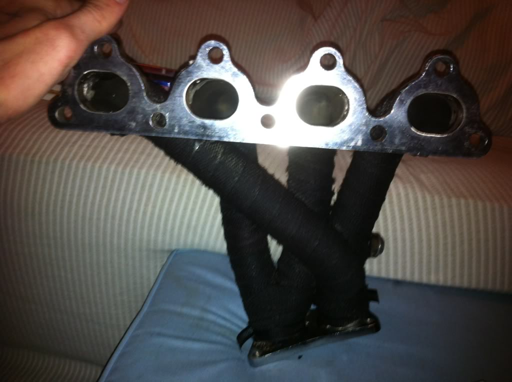

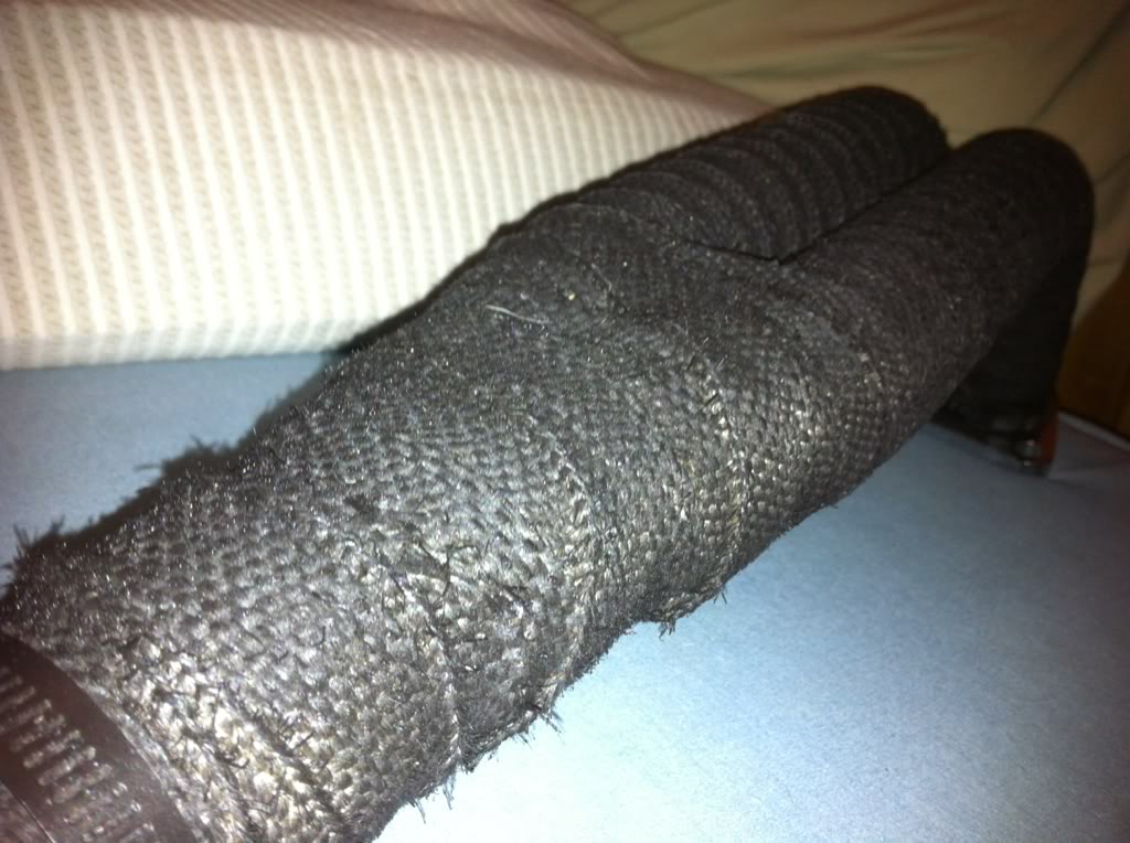

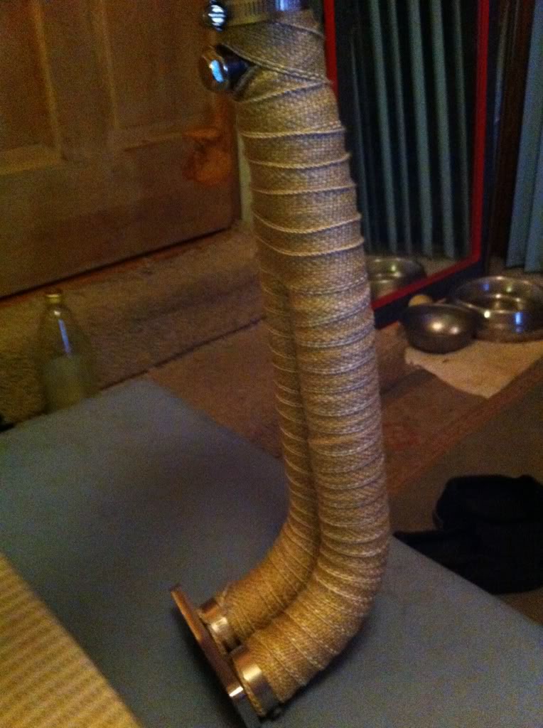

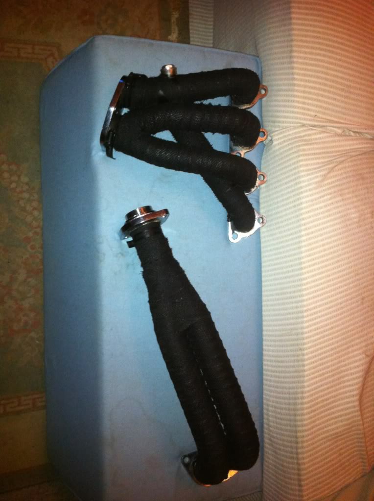

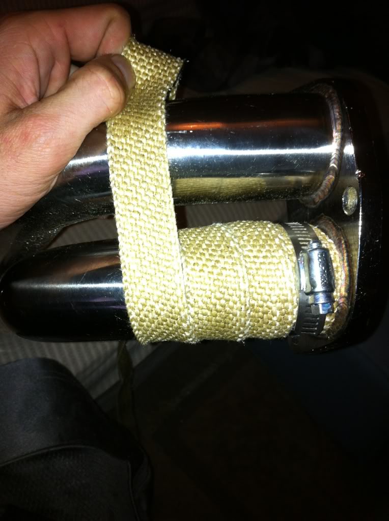

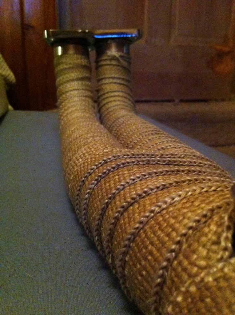

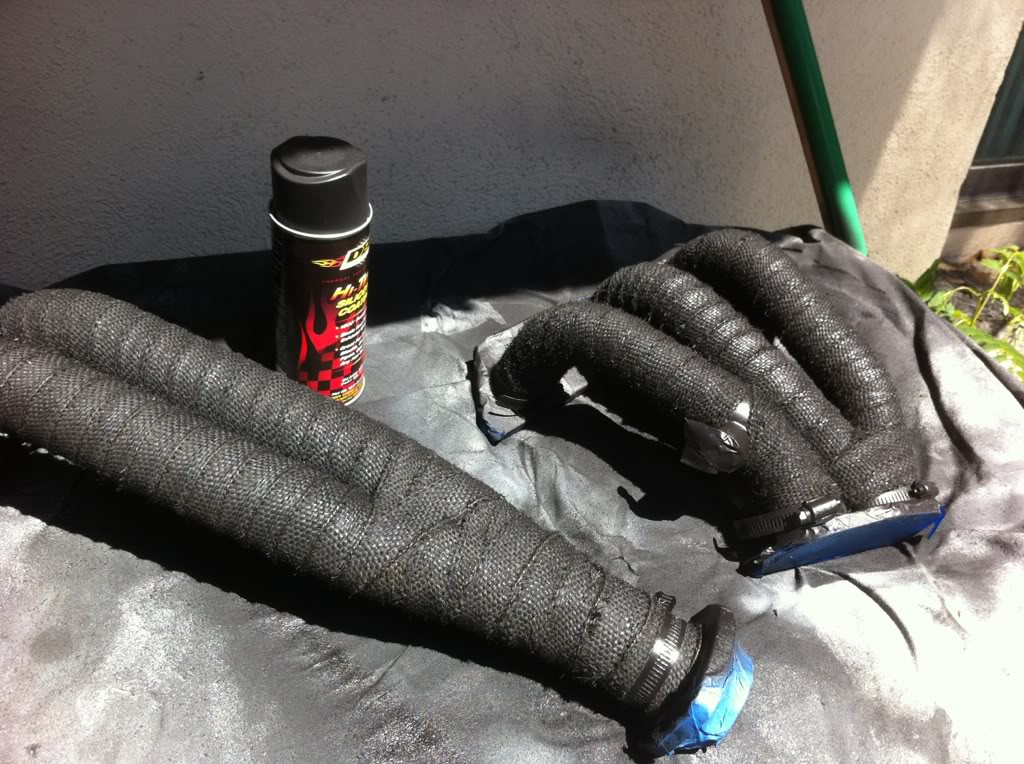

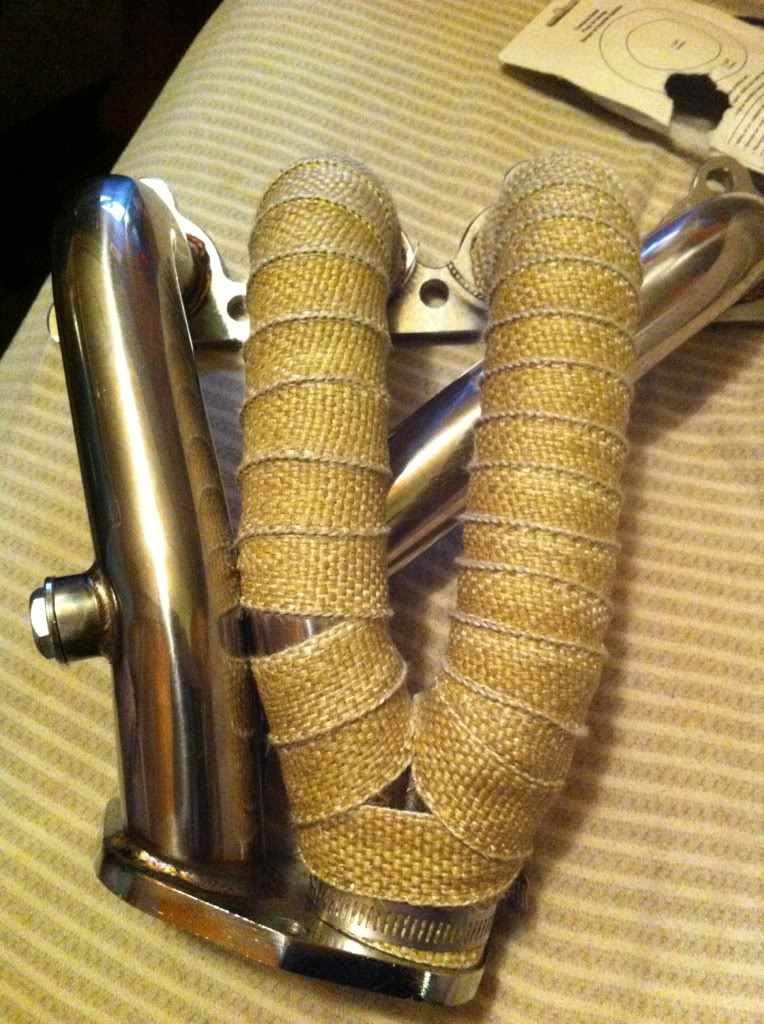

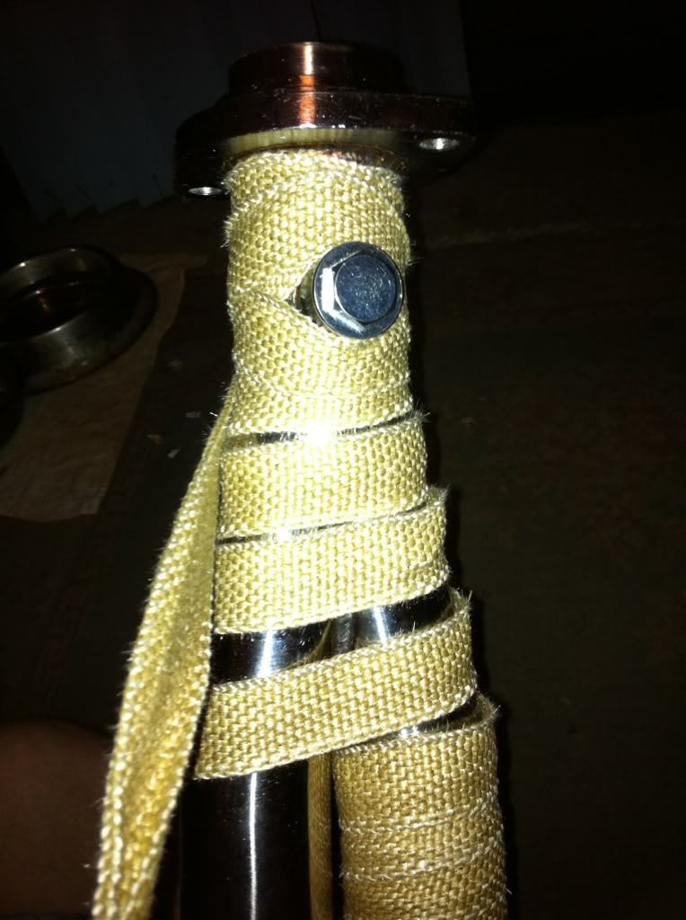

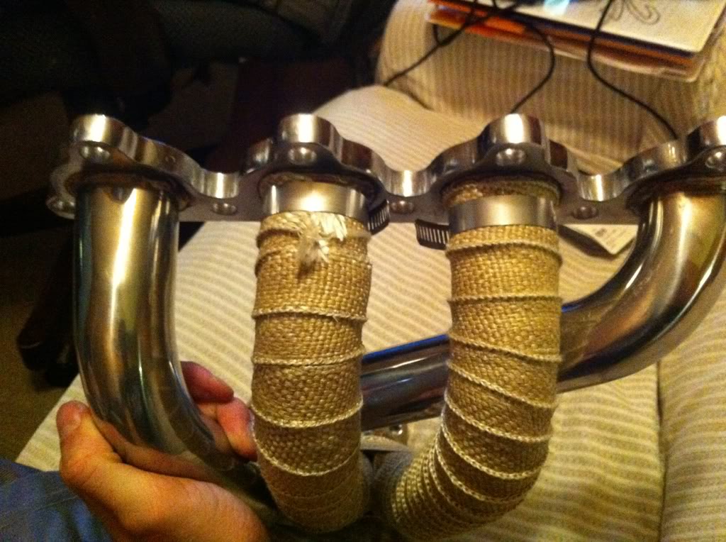

Started wrapping last night, doing bottom half first...

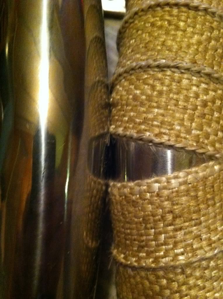

Did kind of a half wrap down here since I go over it twice, I went down one tube to the end and then back up the other tube...

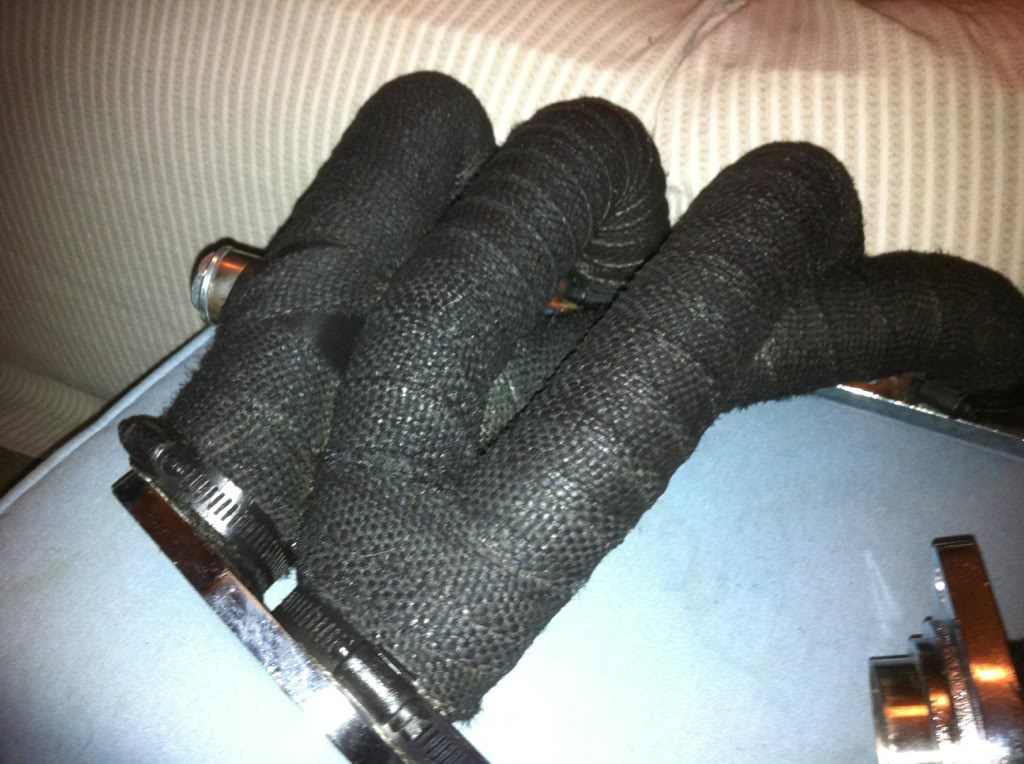

The whole time I tried to overlap by a half inch, but alas I did not have enough wrap (50' was not enough, should have got 75') so when i did the header I could only do 2 pipes and 1 is over lapped by ~1/4" so save material. Gonna have to go buy more today or tomorrow... Also there are parts where it is just too tight to get the wrap through, it just is not possible so I have small gaps, I hope that does not defeat the entire process but I cannot image that a small heat leak will cause much damage to the flow.
Not the most flashy looking wrap but that is not why i bought it! Although I will probably rewrap the ~1/4" part to make it better, also i really should have followed DIY better, should have worn gloves IM SO ITCHY!!!! and it does not help that i did it on my couch!! agh, luckily my couch has a cover i can just wash. I will finish wrapping this week, catalytic converter is in the mail somewhere in the mid-west and should be here Friday the latest which probably means install next week which gives me time to find someone that will actually install it or at the very least make me piping. I have one small shop that says the will do it and do not care but we will see what happens when I actually show up (friend of a friends families shop). Everything else is great, no squealing from brakes since I cleaned them, no over heating, bushing going hard, knock on wood.

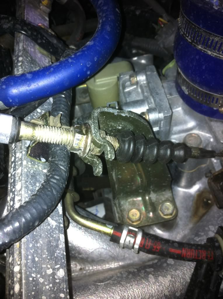

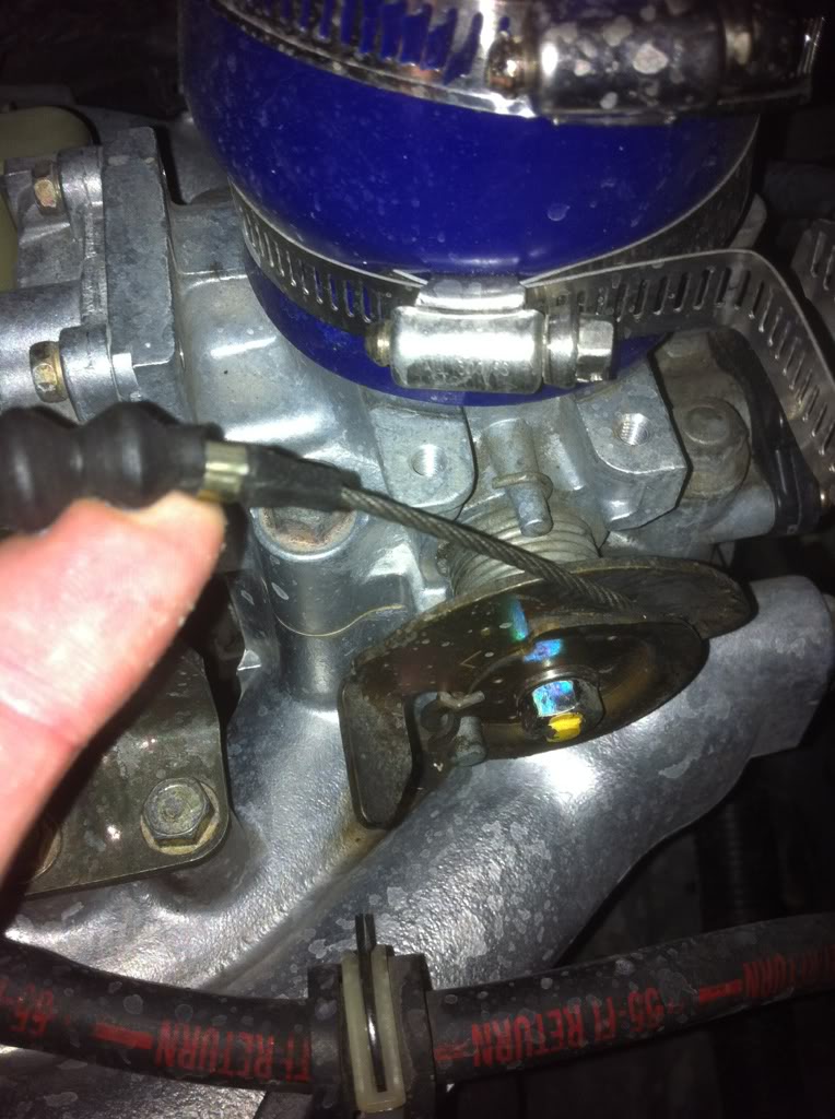

Meant to do this way back but always forget somehow. My car shifts pretty rough and has lag in throttle so I finally adjusted the cable which was absurdly loose (i could lift it inches about where it rested)...
Before:
After:
Adjusting this is probably common sense for a lot of people, but I have to say, this made a HUGE difference in performance. The car responds much better to gas pedal, it does not jerk when i let off the gas (slowing down and shifting was annoying). I highly recommend checking this thing fairly often for too much slack (youll notice too little driving). Tranny is still a little sticky in 1st gear and I may not be the best driver but many people have agreed with me that 1st gear is a little sticky, that will have to wait until I do major mods.

That is odd. I was able to wrap my entire D series header with only 35'. However, the wrap was 2" wide, too.
If that is a cloth header wrap, you can soak it in water to stretch more. Install it while wet and when dried, it will be technically tighter than if wrapping dry. Lastly, do you plan on spraying it down with header wrap sealant?
I did not get it wet, I am gonna redo the 4-2 part, the 2-1 section was not wet either but it pulled it really tight, the shape of the 4-2 was too awkward. I will get it wet and redo the entire 4-2 and I ordered another 10' of 1", which in the end will be about the same as 35' of 2". I did not know there was spray for it, gonna call the shop now and see if I can get it with the extra 10' of wrap.

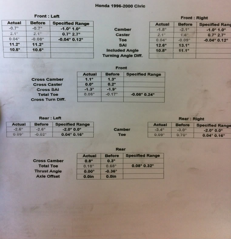

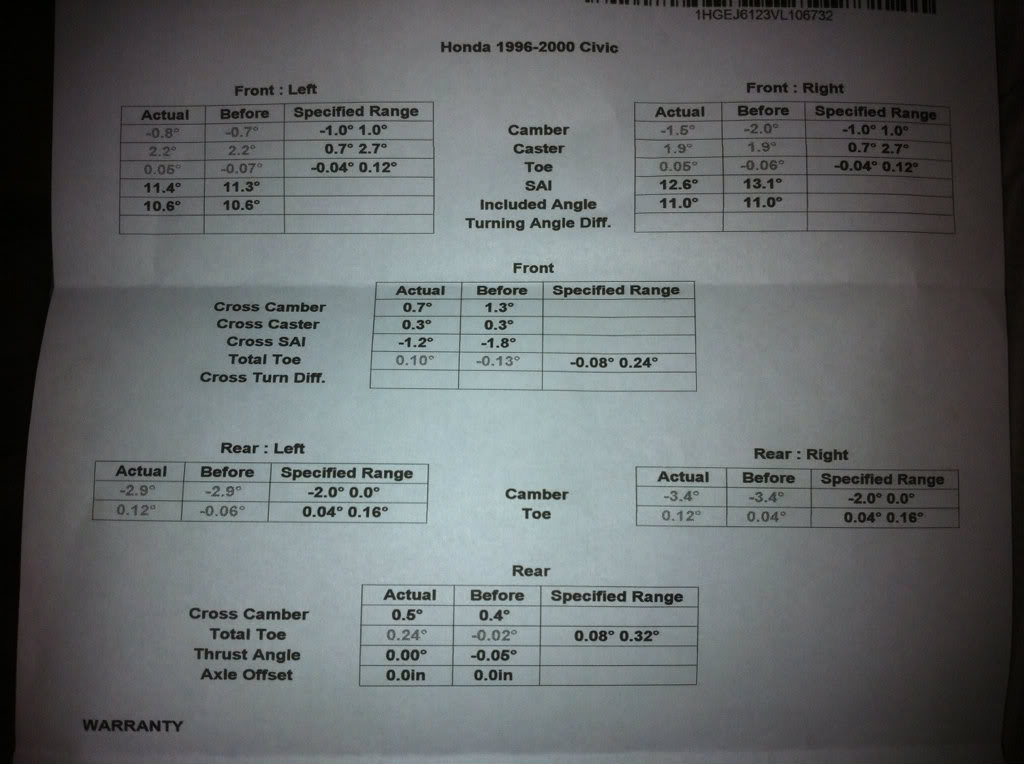

Got alignment done today and good thing i did, my specs were bad...
(also for the people i know that insist only 4wd cars need 4 wheel alignment, wrong)
6 month warranty and the guy that did the actual alignment was very helpful told me to come in every 2000 miles to check the alignment and see if anything is going off again. Hopefully there is not real frame damage but if there is it is very minor

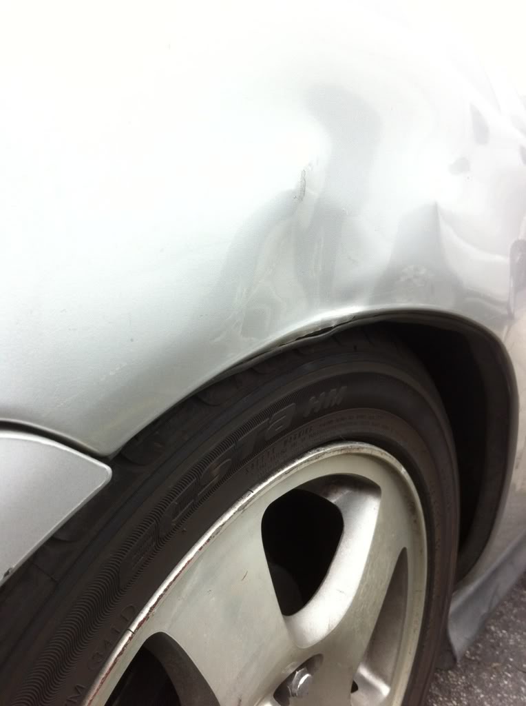

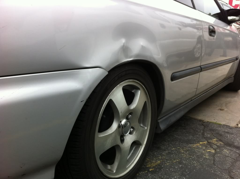

Also really noticed that my rear passenger quarter panel is pretty dent up (from when i replaced the front passenger fender) and hits the wheel on bumps but has a rubber protective seal. I really think I am going to just get a metal rod under there and bend it out. Also a little rust under the rubber not sure if I should take it all off and sand it down (still have duplicolor) and just let it be for now (not gonna leave it but i am scared ill find a lot more rust )

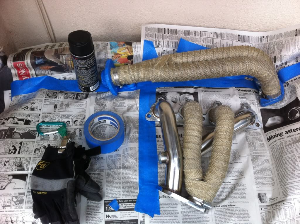

Just be careful when wrapping a header. I am sure you have read pros and cons about them, right? They will accelerate wear on the manifold and possible cause the cheap-er manifolds to cracks easier. That is what happened to mine a few years back.
Old Apr 25, 2012 | 10:35 AM
  #88
Turtlegrip's Avatar
Joined: Mar 2011
Posts: 485
From: Los Angeles

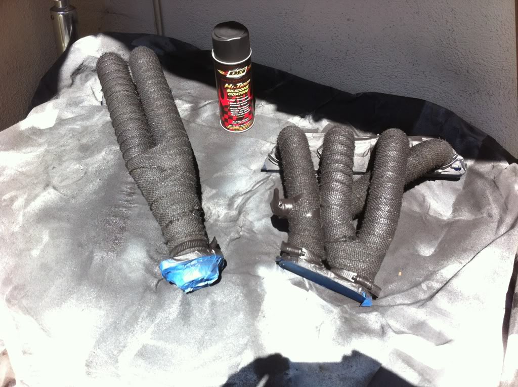

So i have read mixed opinions of this. Most of the information is from motorcycle site though. Anyway, the consensus was that cheap headers are gonna crack, thats that, and that with proper install (assuming you dont live underwater) the wrap dont get wet and cause water issues and in fact it will help the warm up/cool off times which would possibly avoid cracking. But for it to work in this nature a proper install is necessary.
Edit: Just gonna go with the silicone spray. I guess some people just insist that the cans lie and will not last at even 400F, but i think that is an absurd claim. I cannot imagine a company getting away with that especially when many people say they used it fine. Re-wrapped the header both 4-2 and 2-1, used gloves, got it wet, a million times better wrap but same difficulty which is just time. Looks better now though. Drying and waiting for more wrap to come. Will paint the 2-1 tomorrow once it has had ample time to dry.

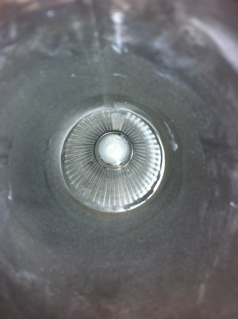

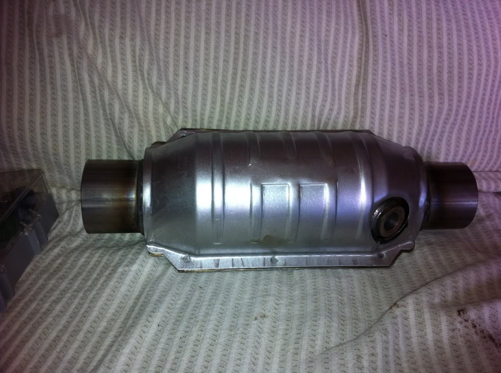

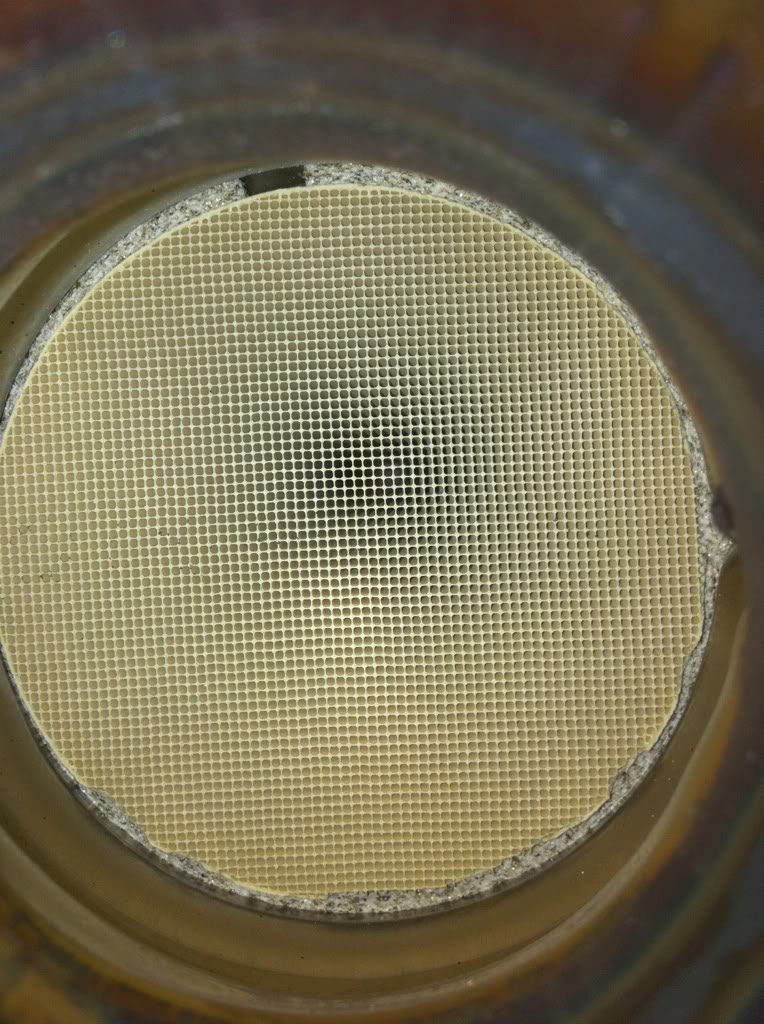

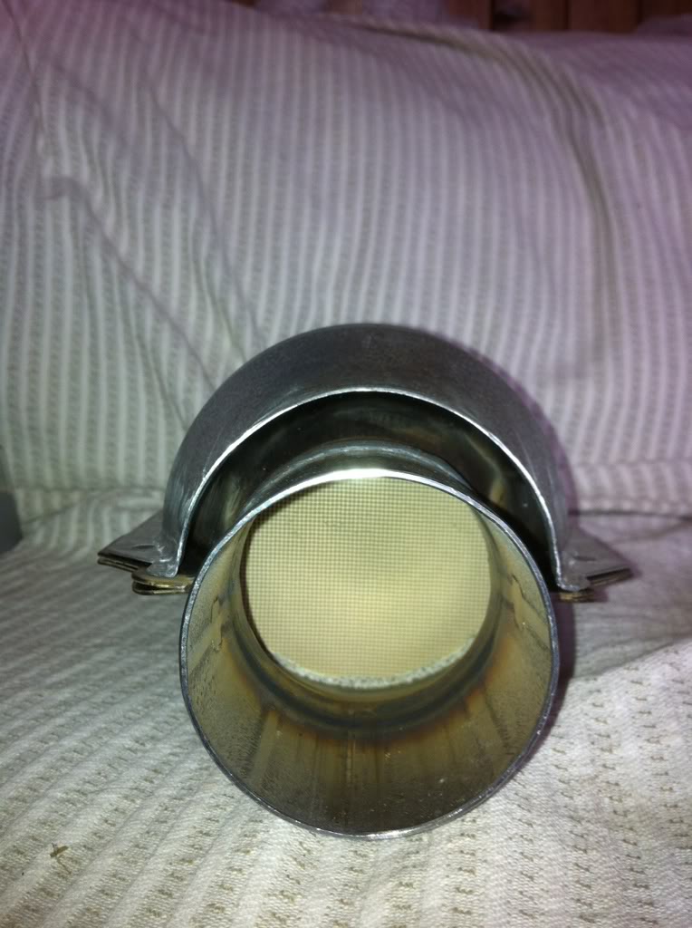

Catalytic Converter came:
