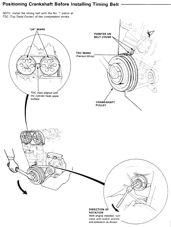

Spark at the plugs should be bright white rather than weak orange or deep blue. What did yours look like?
Any CEL codes?
If those are fine, check the mechanical timing to see whether the timing belt skipped a tooth or two.
