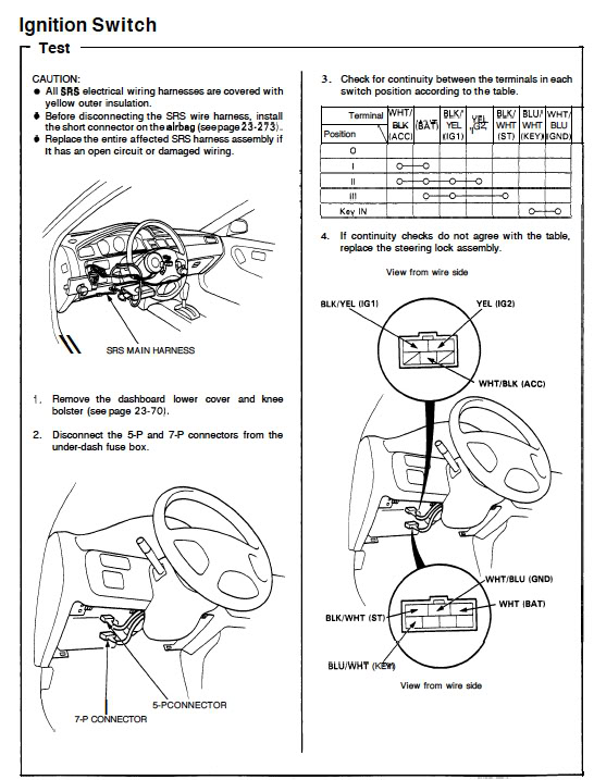

No voltage going to the clutch safety switch....going to pull the steering wheel open now
Old Aug 20, 2009 | 12:56 PM
  #22
You tested voltage with the key in ON(III), right? If so, check the ignition switch:

when checking for continuity am I lookinf for12v?
Old Aug 20, 2009 | 01:21 PM
  #24
Continuity indicates low or no resistance (Ohms). So no, there are no voltage measurements. Just do all combinations of tests in a pairwise fashion on the disconnected switch as shown in the diagram. You are most interested in the continuity tests for ON(III).

Testing continuity between Bat and Blk/Wht (St) in ON(III) is what you are most interested in.

not finding the 7 prong plug
Old Aug 20, 2009 | 01:49 PM
  #28
wjd03's Avatar
Posts: 32
i got the 5 prong but cant find the 7
Old Aug 20, 2009 | 02:18 PM
  #29
wjd03's Avatar
Posts: 32
yea i have problems w/ continuity on blk/wh stripe reading 1 wont 0 out
Old Aug 20, 2009 | 02:23 PM
  #30
What is your multimeter set to read? Are you talking about continuity between Bat and Blk/Wt(ST) with key in ON(III)?
