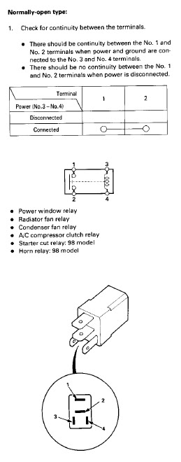

First double check whether fuse 24 (under dash) or 46 (under hood) are blown.
Next test the PW relay in the under-dash fuse box.

how would you go about checking that with hand tools and with checking all that
Old Apr 18, 2008 | 06:56 PM
Default RE: 96 civic ex PW prob
Visual inspection is usually sufficient to see whether a fuse is blown. The internal metal wire connecting the two terminals will be broken.
To test the relay, you'll need both a continuity tester and a source of battery power (your car battery). You can purchase an inexpensive continuity tester from an auto parts or hardware store.
