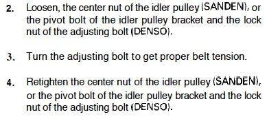

You have three separate drive belts for the power steering, A/C, and alternator. The A/C belt tension adjustment is done through the center idler pulley:

Default RE: A/C belt - tighten
This is where the haynes manual was completely useless on my 92. I'm not sure if they are the same and I can't see the pics that the previous poster posted because my server at work blocks them out.
On the 92 you have to loosen the nut in the center of the pulley (not the one on the compresser, the one on the pulley) and THEN adjust the screw at the top of the pulley bracket tighter or looser.
I didn't loosen the one in the center and couldn't figure out why I couldn't move the pulley up and down. Duh!

Thanks guys, this helpeda lot! The book is wrong. Here is a picture. I had to take off thepower steering belt to get to it. Once I got it tight, sound went away. Here is the pic.
[IMG]local://upfiles/30638/560B399BEA6E4605A56033C672F49EC9.jpg[/IMG]
[IMG]local://upfiles/30638/26E8DD54563345C38A7C029C9F8CD359.jpg[/IMG]
I tried to embed the picture, you can tell this is my first time. Let me know if you see the pics.
