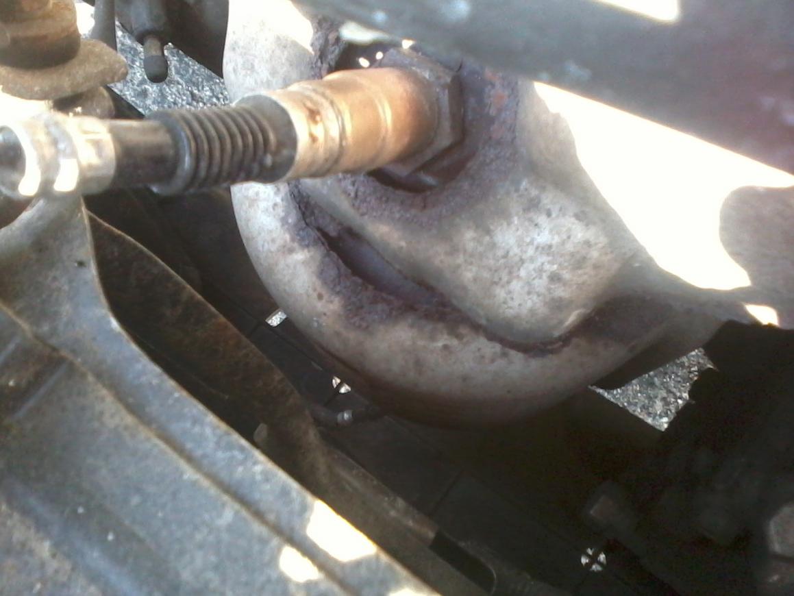

Check if your exhaust manifold is leaking. The LX combined manifold / converter is prone to crack in the center, which will cause bad readings from the O2 sensor.

Look for a crack and if that doesn't help, look under the hood and listen to the manifold area while idling for air leaks.
If there is a crack you will probably notice. Make sure to look in nooks and crannies that are hard to see because of the heat shield.

I took this picture. I looked for obvious cracks on the manifold and didn't see any. As seen in that picture, there is an area of corrosion on the manifold/converter. However, I started the car and put my hand infront of that corroded area, and I didn't feel any gases escaping so I don't think that's the cause. I'm at work so I don't have a chance to remove the bumper to check more thoroughly, but I checked everything I could under the hood.
