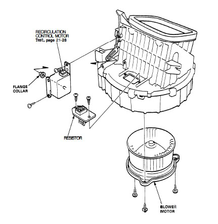

Just unplug the connector and remove the three screws. The blower drops staight down and out.

You guys was rite the fan was full to the top plus of newspapers and everthing else you can think of.. We had to do it twice to get all the junk out of everything and now get way more air flow out it than it had when bought new.. thanks to everyone
