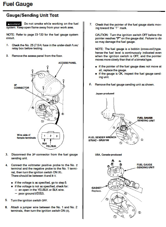

Here's how to troubleshoot the fuel gauge:
