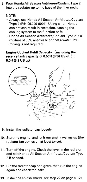

I agree with mundy. Start by checking the coolant level in the radiator when the engine is cold. Top off the radiator and reservoir if needed. If the coolant level seems fine, then bleed the cooling system of possible trapped air:

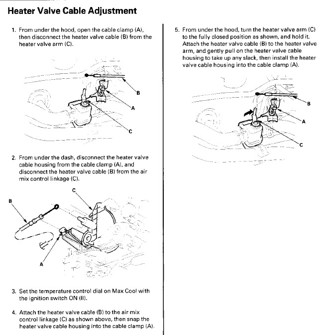

Might also be worth checking the heater valve cable adjustment:
