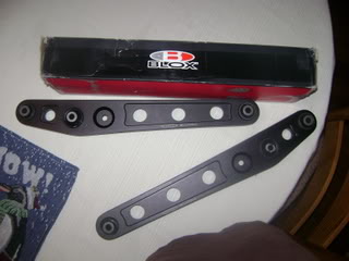

Blox: (couldn't find a pic of them installed )

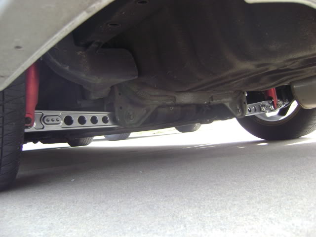

Skunk2:
Current set-up (picture whoring! woot!)

I still have the Blox LCAs with torn bushings in my garage, I'll snap a picture when I can. I would definitely keep an eye on the bushings if you buy anything that looks comparable to the Blox set-up.
