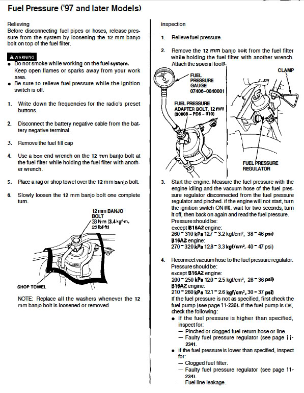

Old Apr 17, 2010 | 01:02 PM
Note the fuel pressures with and without the vacuum hose to the fuel pressure regulator connected. Start at step 3.
