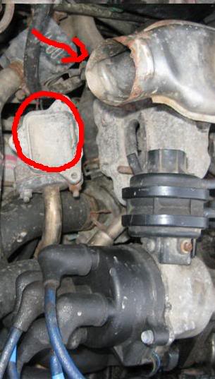

below is a picture of my engine, which is missing a (at least one) connective valve. it screws on to the area circled, which originates in the exhaust manifold. It should pump hot air up to somewhere, which should prevent water in the air in my carburetor from freezing and messing my **** up. I dont, however, know where it goes, or even if this is really the problem. (my car stalls and wont start for a while when its really cold out and its been sitting) the guy i bought it off, being a bit of an idiot, wasn't much help either.
anyone here know stuff about old (87) civics and where this is supposed to go so I can jimmy one together? I suspect it goes to the air scrubber, which is underneath the intake for the air filter (red arrow) but i honestly dont know.

it might be something like a heater valve that runs from the exhaust to the carbed intake valve to help with cold start ups. i know my old 86crx had it on the motor/intake. you can just buy a new metal like dryer hose from autozone for it, but its hard to tell with your picture... can you post a more complete engine bay shot or afew?

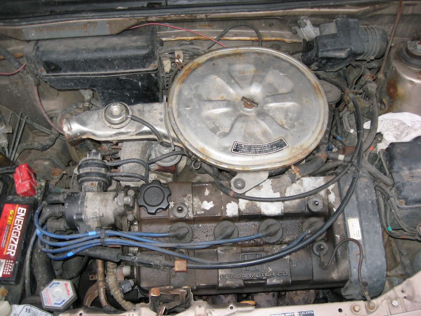

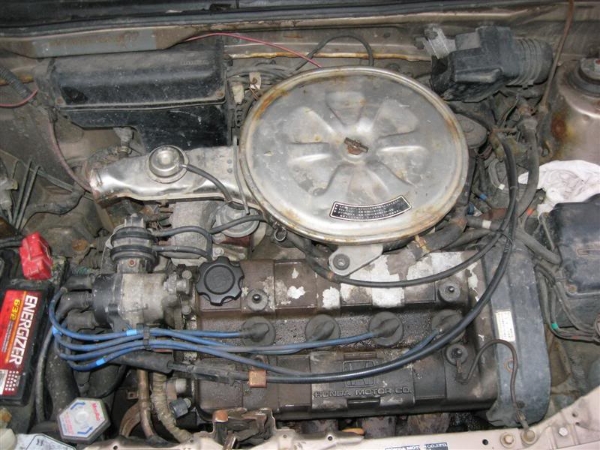

so heres 2 shots, the first is the whole engine bay, sorry its pretty gnarly looking right now, been driving alot of pretty muddy backroads around here.

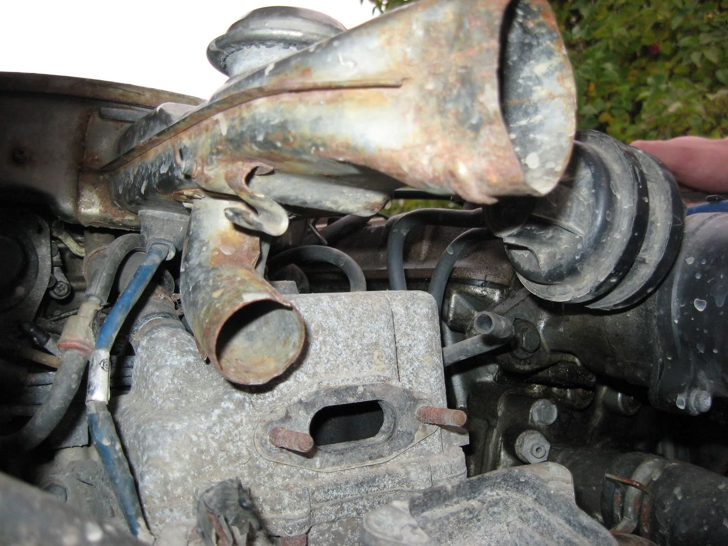

the second is the area of concern. the bit that runs from the exhaust manifold that was circled in the previous picture is in the bottom right, and it either leads to the lower hole with the bolt holes on either side or to the air scrubber attached to the air filter casing (the small upper hole)
1st:
2nd:
1st:
2nd:

so you curious about the lower oval opening on the intake manifold, or on the air intake?
if the air intake. that bottom angled circle piece is for a heater tube that should run around the manifold somewhere... it doesnt connect to the exhaust itself but more less a heat shield around the manifold. it could be a swaped motor.... my 86crx had the same carbed intake but wasnt a DOHC motor....
the top angled part should have a plastic tube that runs around the battery area but not really needed.
but im not sure what that side oval opening is..... might be something for a egr valve.

if it doesnt want to run when its cold out simply run a metal bendable hose to run from that lower tube and zip tie it around the manifold so it kinda sucks air off of the header. not perfect but if its a motor swap thats the best you can do...
all it does is suck the hot air off around the runing motors manifold to help warm the motor up faster.

sweet dude, thanks, question answered. I think i might get the carb rebuilt, and i just found out it is a swapped engine. there is a solid metal pipe set up that runs down to the exhaust manifold (circled bit in first picture) so If i just jimmy the two together, i shouldn't have a problem. Yea, i hate carbed engines, but whatever, the car cost me next to nothing and its 4wd so itt'l do the trick.
