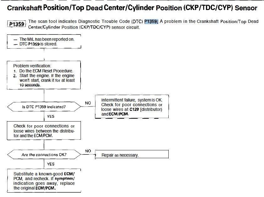

P1359 may indicate a problem with a wire running between the distributor and ECU or a bad ECU (see diagram). It sounds as though you are getting bum starters from your auto parts store. Get a refund and purchase a new starter elsewhere.
