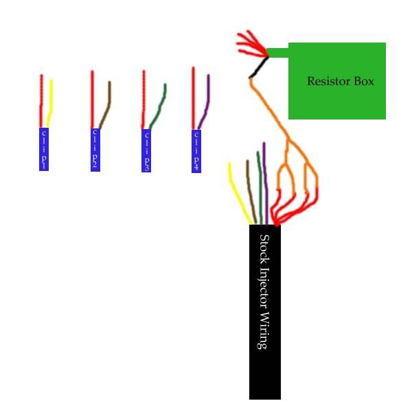

I have been convinced to change from OBD2 to OBD1 so I can run 11 psi.
What can I do about injectors?
I would like to run stock eagle talon 440cc, but will I need a resistor box?
Are there after market ones that I won't need a resistor box?
Any suggestions?

DSM injectors are typically 450's, and yes you'll have to run a resistor box. Its not hard to wire up.

Do you know where I can find wiring for the OBD2 to OBD1 injector plugs?

You'll need to look for "a resistor box and obd1 injector clips"
If you're referring to the OBD2 to OBD1 conversion harness, check out rywire.com and ****** an OBD2B to OBD1 conversion harness.
You'll also need a new ecu

I am picking up a new ecu anda resistor box.
I already have OBD1 injector plugs, so I guess I need to know how to splice the plugs in and how to wire the resistor box.

As crude as this image is, it tells you exactly what to do.
