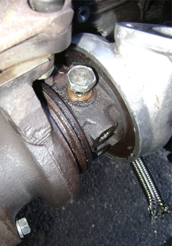

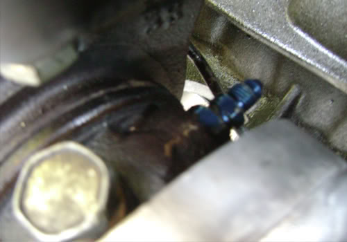

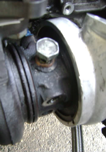

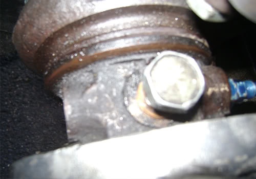

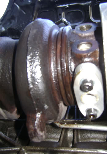

The clamp is off in these pictures, from the looks of i don't see any thing that's holding the section from rotating
The clamp is off in these pictures, i don't see anything holding it on around the entire center section, why won't it spin?

Your oil feed is the 12mm banjo bolt on the top of the turbo, it looks like it's already in the right spot. Oil drain is on the bottom. The coolant ports are both 14mm banjo bolts, the one on the front of the turbo is the coolant inlet and the port on the back is the coolant oulet. As far as I know, you can not mix the coolant ports around.
I found this on a dsm site, How to clock dsm turbo's:
"there is a pin where there exhaust housing meets the center section... chances are, that will break anyways when you try to separate the exhaust housing. for the cold side, that one is slightly harder with the C-clip and all.
you jus thave to worry about how you want to mount the Wastegate actuator... or eliminate it and run with an external. then you are free to clock any way you see fit."
Old Oct 10, 2008 | 01:46 PM
FlipHKD720's Avatar
Posts: 8,442
From: Marquette, MI
Yeah man i searched around alot and found some aweomse info on the 14b, or all the td05's. Yeah its the band-clamp around the center section, the remove the WG actuator, remove cold side, then use this snap-ring pliers to get this BIG *** snap ring off the compressor, then you can clock it. On top of that, yes you need to break off or grind down the locator pin, but you're right, all my ****s all lined up already. I randomly had a adapter that was PERFECT for my oil feed, fit into the turbo perfect and the oil feed line screwed right into it. So i just need a new oil drain flange since i broke it off hammering on it with a hammer, and i should be good!
