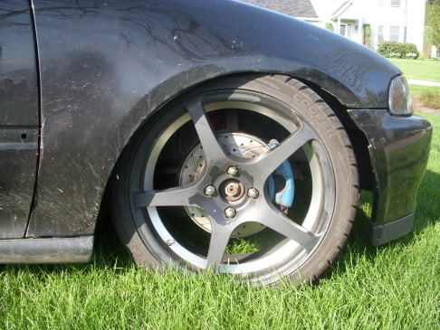

Also, I'm just going to throw it out there that it's extremely hard to find a place willing to turn a drilled or slotted rotor. They tend to chew up the teeth on the lathe, so most shops won't do it.
But if the car is 100% a street car and it won't see any track duty (and you drive like a normal person), the only reason to get drilled and slotted rotors would be the aesthetics.
And people that remember my civic might remember this little detail:
I had cross-drilled and slotted rotors on all four corners; I got them because I needed new rotors anyway and I liked the look. Rest assured, I felt no difference between those rotors and blanks.
Again, as far as controlling heat, get larger rotors. Larger rotors = more surface area = better heat dissipation. End of story.
