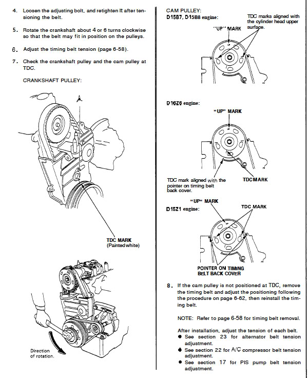

The diagram shows how to check the mechanical timing. This procedure requires that you remove the valve cover and the upper timing belt cover. To check for TDC1 synchrony of the cam and crank, use a small breaker bar to turn the crank pulley from the crank bolt only in the counterclockwise direction.
