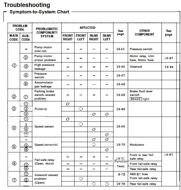

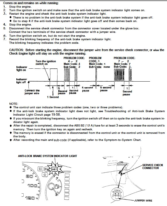

Pull the ABS code. It's probably a wheel sensor and the code will tell you which one. The sensor could have been damaged while changing the axle.
The ABS should not be doing anything during normal stops, only on stops so hard that the wheels would skid on a non-ABS car.

Old Nov 23, 2008 | 08:17 PM
The diagrams below were taken from the 92-95 Civic service manual, which can be downloaded at the link in my signature.
