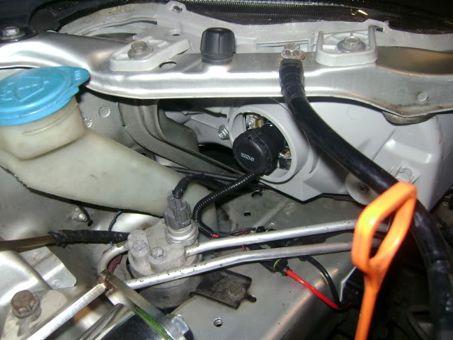

Back of the driver headlight:

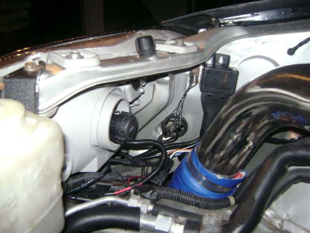

And the rat's nest behind the passenger side. Dont worry, it'll all be tucked eventually.
The driver side headlight shakes around slightly when driving, so I will be switching the bulbs and seeing if the problem goes away, or if it continues on either side to narrow down the problem. If that doesnt help at all, I will be swapping in the OEM Honda headlight housings and seeing if that makes any difference. After that, I really can't think of what I would be able to do to stop the vibrations. I doubt the 75A mounts help

you could put the factory rubber seal back on, and it may hold the mounting sleeve a little better and help with the vibrations.
and ya my wiring behind the passenger headlight isn't the best either, but you can't see any of it on my car because the factory air box covers all of it up.
also I'm waiting before I completely make the wiring looks good because I'm thinking that one of the ballasts may be bad. So I don't want hide all the wires really nice then have to undo it in a couple of days.

My black housing headlights shook when I had HID's in them. I assumed it was the quality of the headlight compared to that of the OEM headlights.
Old Jun 15, 2010 | 09:35 PM
  #428
I installed the rubber headlight seals and they definitely did help, but the driver side is still shaking a little bit when the rpms are between 2800-4000. Next step is to switch the bulbs around and see if the problem is still on the drivers side, or moves over to the passenger side with the bulb.
Old Jun 17, 2010 | 08:03 PM
  #429
Okay switched the bulbs around, and the problem moved with the headlight to the pass side. Obviously, a problem with the bulb. I compared the bulbs to each other, shook them and sure enough, the problem child made an excessive rattling noise. Ended up sliding a piece of folded electrical tape where the bulb was "loose", and the shaking stopped! I will report back when I am able to actually drive with them in, instead of just turning the car on, and slightly revving the motor up.

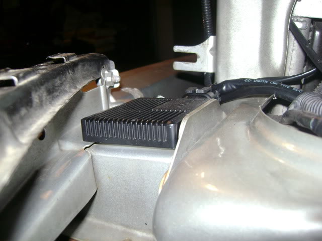

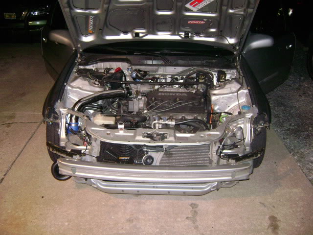

-Front end off, and showing where I put the ballasts:
-Up close of the ballast. I really think this is a prime spot for them. Out of sight, no dirt/water marks on them at all, and no wiring issues. They have been installed for about a week:

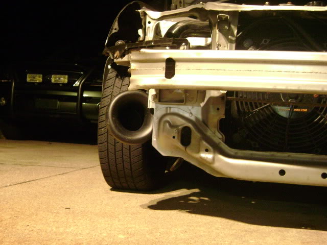

Pic of the Velocity stack mounted (you can kinda see it in the first pic above...):
