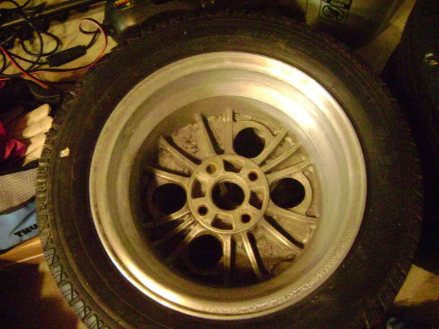

Wheel Clean-age:
Only the insides of two are done right now. Ran out of sandpaper. Should be picking up some more this weekend.

Rims are lookin good though!

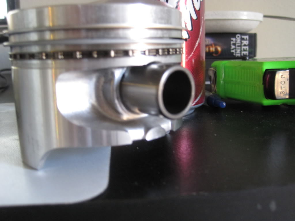

Do your d16a1 pistons come with a place for the snap rings or does the wrist pin just sit in there?
I have no clue. Never done it before, so I don't know what to look for exactly. It may sound dumb, I know.
I plan on putting the rods/pistons together tonight or tomorrow. However, I am really trying to get these wheels done asap. The backs have been cleaned up, and the face (outside) of one has been sanded. I think I put in about 6 hours so far sanding.

^ The more time and effort put into the job the better it will look in the end.

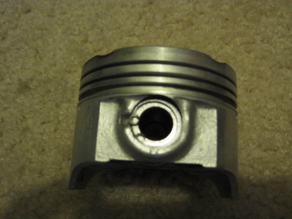

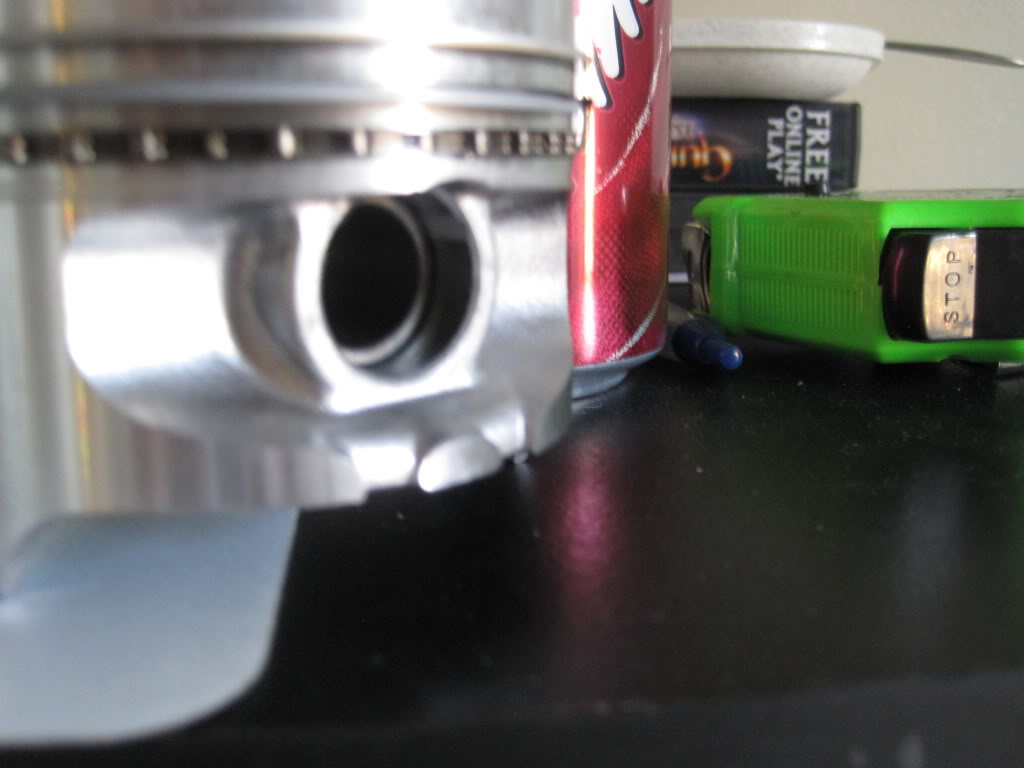

Well see i have the same high comp pistons as you out of a d16a1 (they came with my bearings) but here are pics comparing them and the vitaras i bought...
Here are the Vitara's with the snap rings holding the wrist pins in place inside the piston.
Now here are the d16a1's which have no snap rings or slits to put snap rings to hold the wrist pins in place allowing them to freely move.
