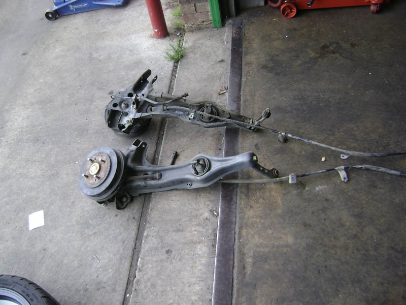

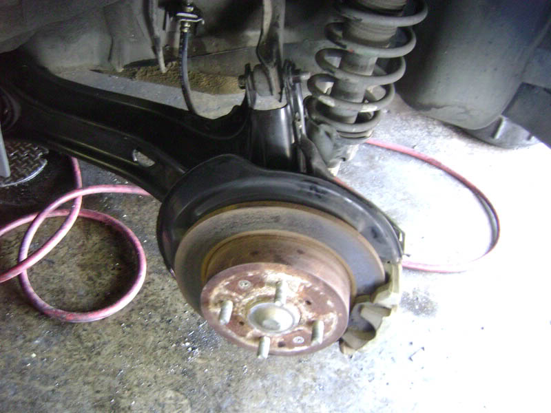

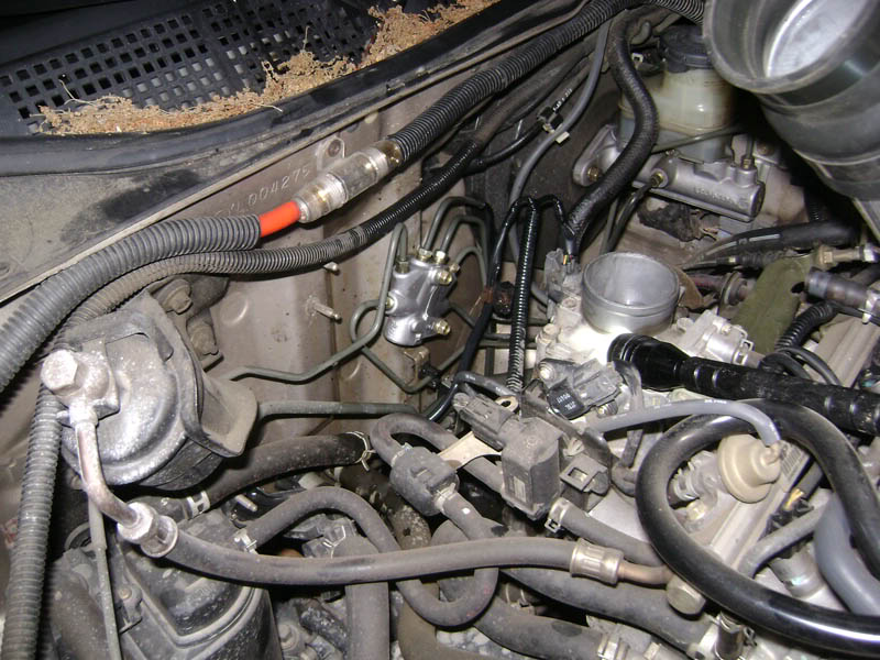

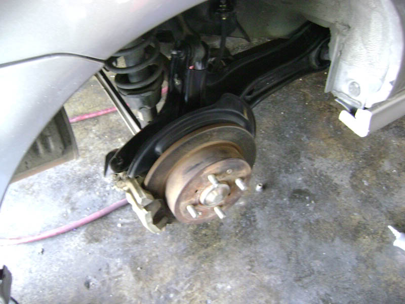

Anyways, to the progress. Got the brakes installed today. It went without a hitch. The install even took much less time than they expected. Turns out that the rotors didn't need to be turned and the pads were fine. Everything just needed to be worked a little. Once they were on the car and spinning, the terrible noise stopped. Guess they were just rusty as hell.
New prop valve, yeah it looks the same:

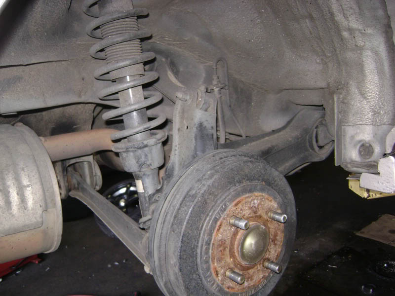

Goodbye drums!

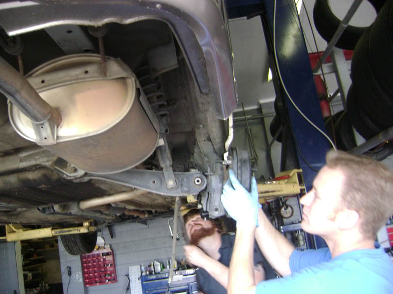

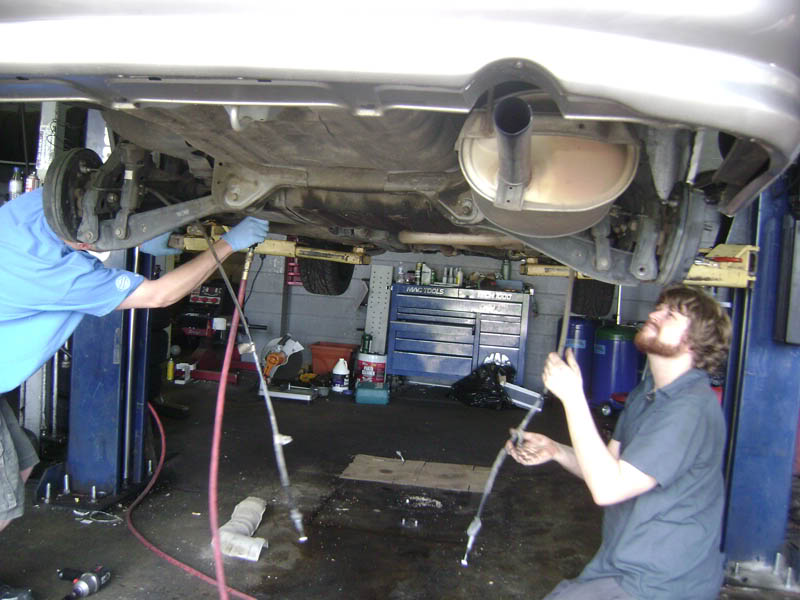

The guys double teaming the brakes starting with the ebrake cables and A arms:

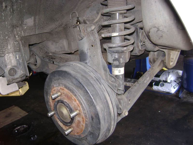

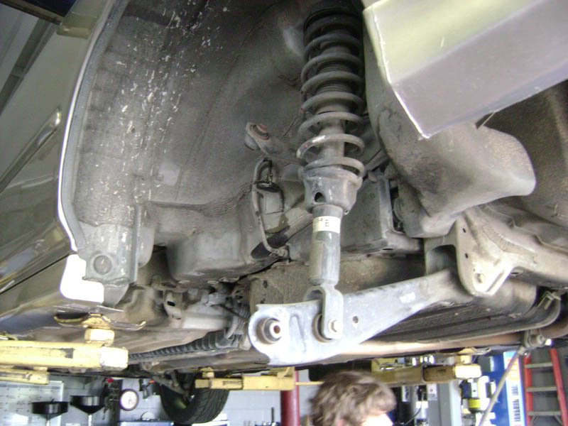

Driver's side gone:
Passenger side on the way out:
Bye bye drums! The guys at the shop are sending a team to that 24 hours of Lemons race. From what I understand, these are better than what they've got on their car (4th gen Civic sedan, D16a6 5 speed, ...really stinky car. Not a lot of paint.) and they don't leak so they'll be swapped in. At least in part.

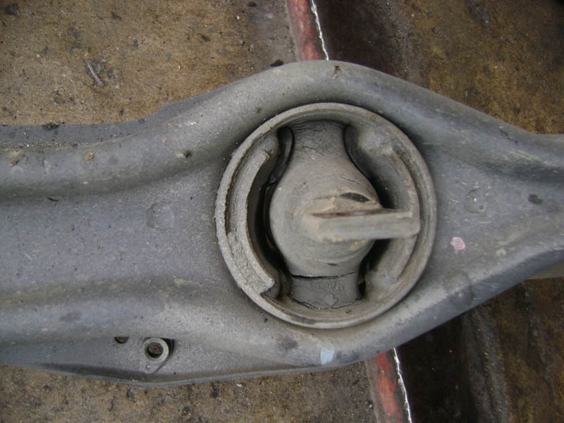

This is how bad the bushings were. Well, the other one was worse.

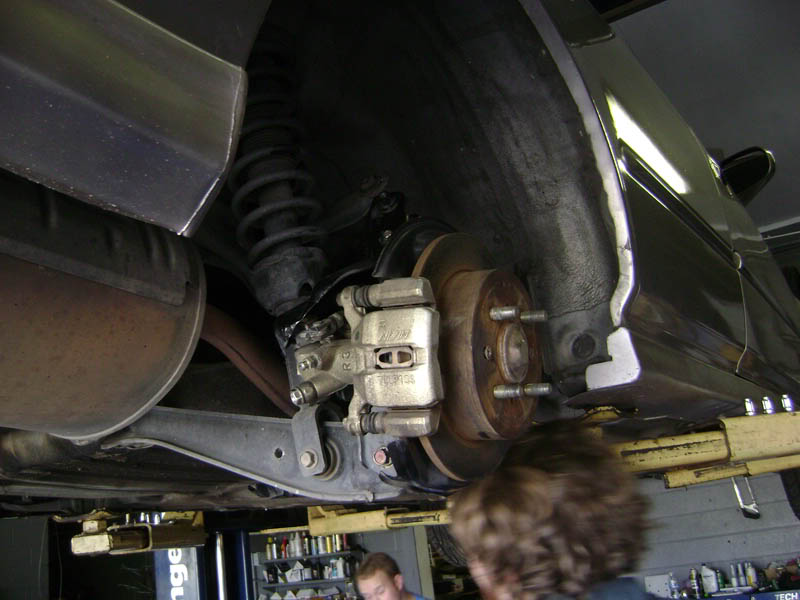

Halfway bolted up:

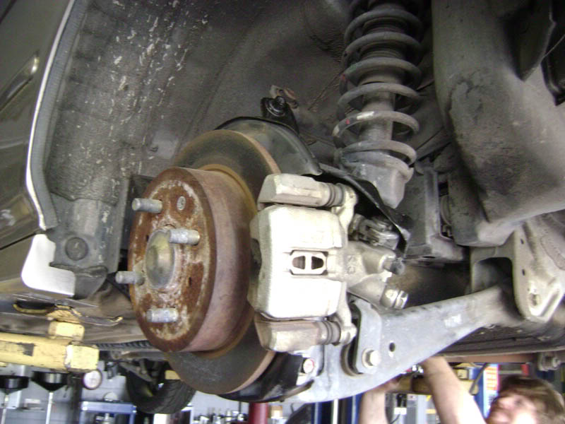

All bolted in:

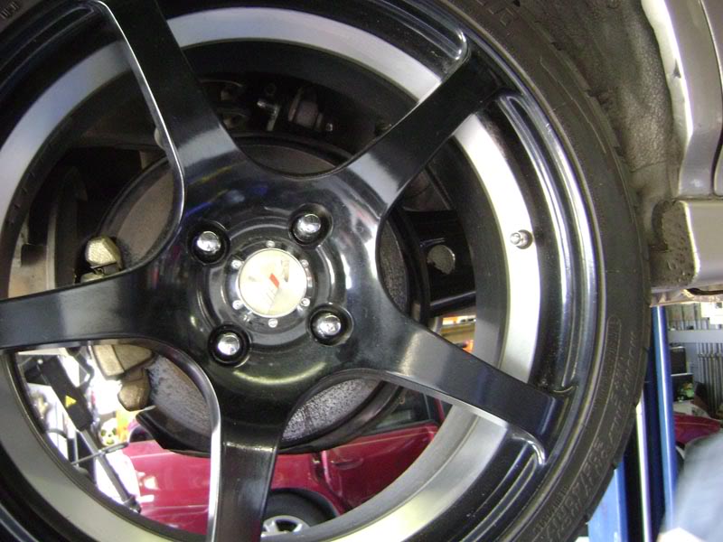

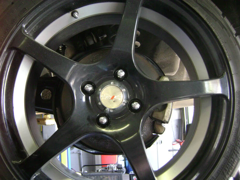

From here, we refilled the system with Wearever Synthetic DOT3 brake fluid and bled the system. Next step was an alignment.
Ready to head off to the alignment shop:
Daniel took it down the street to his buddy's shop where they do all the alignment work and exhaust work. Got an alignment and MY STEERING WHEEL IS STRAIGHT NOW. lol. Got it back and drove it around. Works fine. My brakes are both weaker and stronger. They feel more solid now but you have to press the pedal closer to the floor to get power. It's strange and will take a bit to get used to. They will work fine as is, but at some point I'll want to upgrade to the larger master cylinder.
