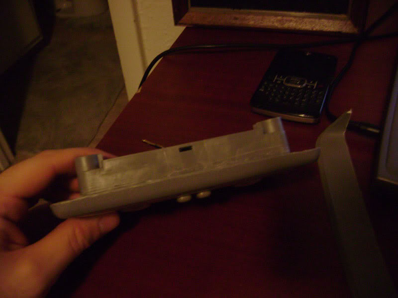

Well, I snagged an Integra map light off that same wrecked 97 Teg LS. Cheap as free, hey. I know these swap right into an EG but I'm not 100% sure they'll work with an EK. The Teg had a moon roof. My Civic doesn't. I dunno if I can make this work. But here's what I've started with:

The EG and EK have a different curvature of the headliner. It's kinda reversed. So that rounded part won't fit. So I hacked it off.

Now it'll sit flat on the headliner.

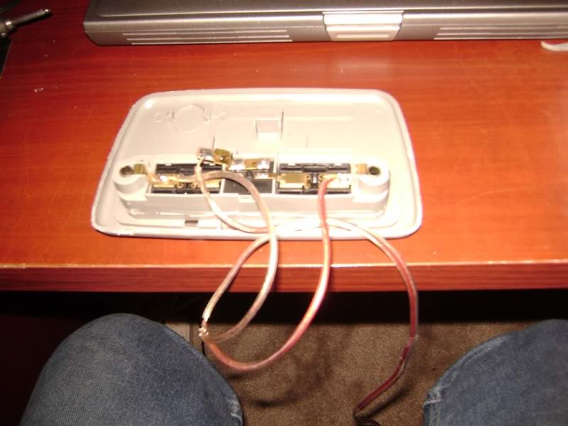

Well, as I thought... the brackets aren't there on the 4 door. If you want a map light, you've gotta do it custom. So as usual, I did it custom.
I soldered wires to the ground terminals and then soldered a positive wire onto the positive terminal. The two grounds came together into one wire and I ran them all to the dome light where I tapped power. Worked fine.

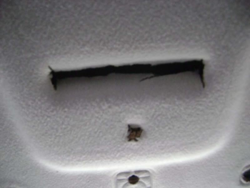

This was the WORST part of the job. Making that first cut was the hardest thing I've had to do lately. If you mess up, the headliner is ruined and you need a new one. I went ahead and slashed away until I had this.

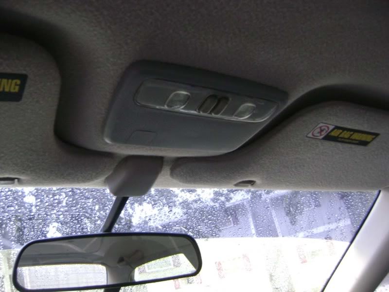

Put the light in, leaving the headliner parts in there to hold the light securely...

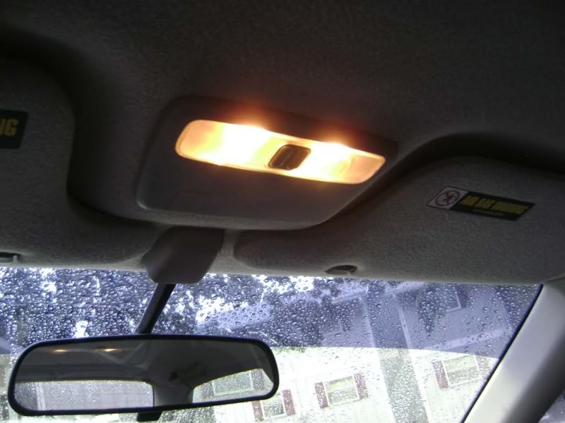

And boom. Wired up and it works.

...and you did it while it was raining. (Or at least that's when the pictures were taken.) You were like "F you rain, I'm gonna work with my lights/electricity anyways" lol.
It looks good itinerant. Definitely looks stock, like it is supposed to be there.
