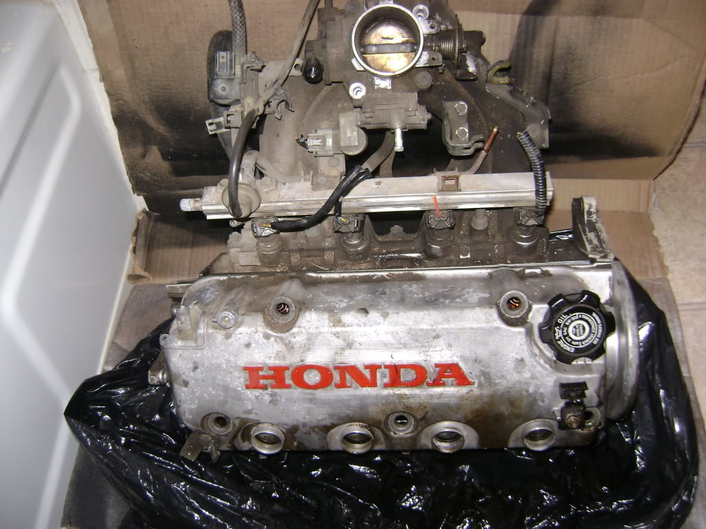

Here's how it started....
So I don't know why I did this... but for $40? meh.

lol ya why...... thats about the same price id pay at my yard for any head.... tho needless to say id sell it for profit
