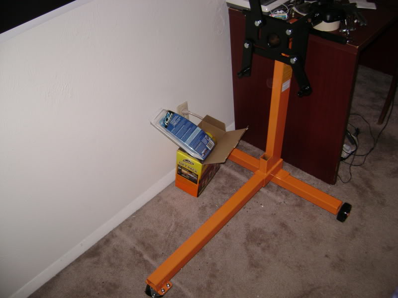

Got a harbor freight engine stand for like $45. Woot.

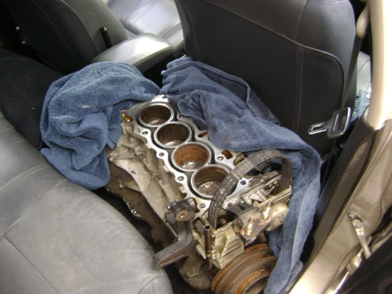

I picked this gem up earlier today, like I posted. Put it together and thought it looked kinda lonely, just the stand there. So I went to the junk yard and found it a friend to play with.
1998 D16y7 shortblock. The engine was complete but the oil pan has a hole in it from where they drained the oil. The head was actually in REALLY good condition but I went ahead and took it off in the yard and left it there. It had a GREAT color to it and everything was clean. Gives me hope for the condition of the block.
BTW, head bolts are HARD to remove if you don't have a breaker bar.
There's minor surface rust on cylinder 3. Don't know why. It wasn't open to the elements. It had a head and both manifolds on it. The crank spins freely enough. This block has 140K on it according to what was left of the cluster. The timing belt looks pretty new. I might use it. Or I might not just to be safe. Dunno yet.
When I got there, the engine was hanging on by the main harness. That's it. Already laying on the ground where someone pulled the transmission off. Easy peasy to cut that harness and drag the engine out. I snagged some of the tranny bolts off the ground so I can put it on the engine stand. If any of you get a junkyard engine, be sure to do the same.
I can't wait to tear this engine down. It'll be a great learning experience. I'll be glad for the wrench time.
The big issue now is getting it into my apartment and onto the stand for cleaning. I hurt too bad to carry it in alone. Maybe I can pay my roommate to help...

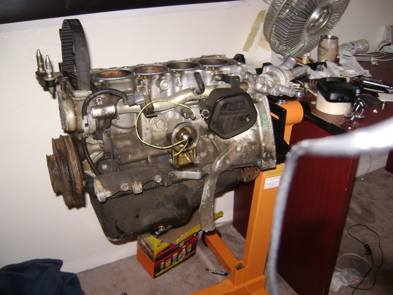

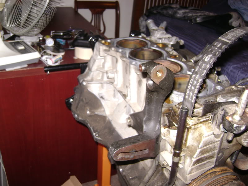

Serious question: I can only get 3 bolts to line up for the stand. Is that enough or do I REALLY need to try for 4?

Sigh. Now I have to clean it. -_-

well it might not be a MUST BUT i would try your hardest to get that sucker to line up!
when i had my old z6 on the stand i had to cut some of the arm off the stand for it to work.
and to clean it up. brake cleaner and a tooth brush works wonders!!!!!!!! but i dont think id do it in your room
and IMO before pulling it apart i would have kept the head on and ran a compression test. BUT its alittle late for that! you never know exactly how good the motor is now that the heads gone! you never know it could have been in great shape and might have been ran with some low boost now.
its not really difficult to build a motor if ya got a good engine shop telling ya what you need after they get the work done. its defiantly a learning experience tho! ive built a few with my dad along time ago. tho havent done one for along time now!
