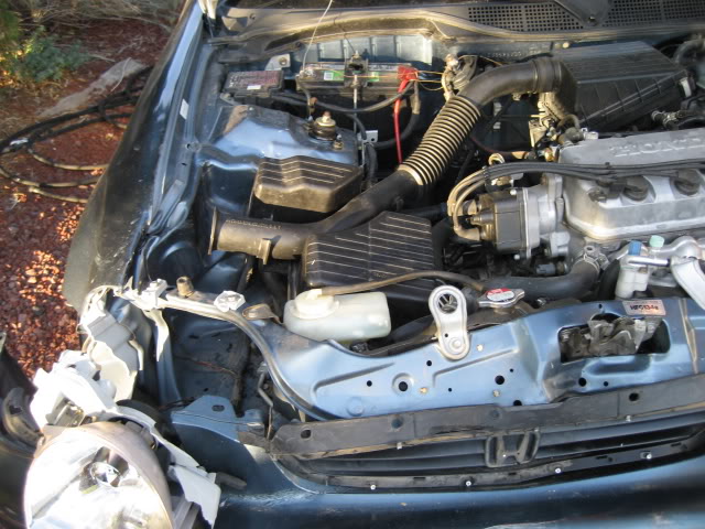

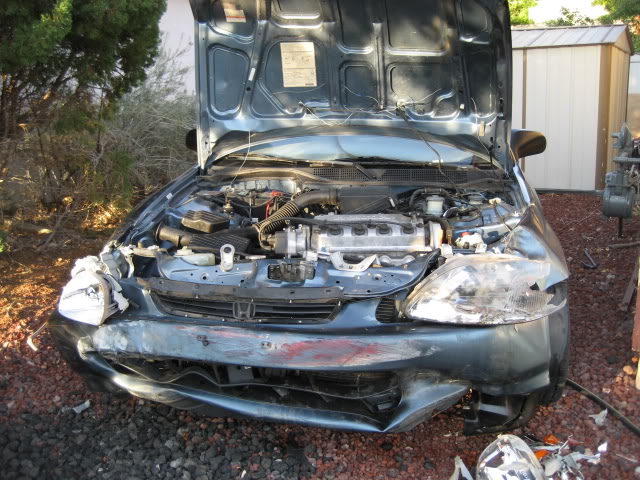

I got restless and started working on the car a bit. I removed my LED turn signals and returned them to stock. I also pulled the hood off and stomped on it to flatten it out a bit for when the rain comes later this week. I pulled the core support back a little by hand to get a look at the front of the transmission. (And I cut my hand in the process, lol. Gloves FTW.) To my surprise, the radiator is intact and still full! The green mess is actually just dye from the AC system.

Google sucks for transmission code info so I downloaded the service manual and have printed some flow charts. Like RonJ says, don't guess. Troubleshoot.
I've skimmed the charts and they all have things in common. The ELD/solenoids/AT Malfunction could all be explained by damaged wires. The O2 sensors... not sure yet. The primary one is definitely broken, but the secondary one was somewhat shielded. We'll see.

well not sure about some of the codes, just check the wires. and post up pics of current state.
for the tranny my guess would be the wires on the solenoids might have got broke from radiator pushed into it or might just be rubber insulation melted off from heat of hot radiator. might be alright. as to the O2 its probably 2nd alright just the first one throwing it off on the computer trying to correct the fuel mix. just be sure to check your wires real good and solder any broken wires or damage wires you can see, and reset the car simply unhook battery for afew mins. and then try again and see if codes come back.
just depends what parts hit what wires. or it might have just been a hicop in the system with the impact.

I was able to troubleshoot and resolve all CEL codes. Transmission codes are gone too. Turns out that one of the plug wires was cut and was grounding out against the shiny new valve cover bolt... That'll throw off the whole electrical system. I'm glad the ECU didn't get killed.
The only remaining CEL is the obvious O2 sensor. The idle is still erratic, and I assume this is due to the broken distributor cap. (There's just a chunk missing out of it, but the side with the contacts is intact. I doubt it's perfectly aligned, but it runs enough. (Still thrilled that the radiator is intact!)
Here's the full list of accomplishments for today:
  • Removed LED turn signals and reinstalled incandescent ones
  • Flattened the hood out enough to mostly cover the bay (just in time for the rain!)
  • Removed the remaining headlight (which was actually only slightly broken)
  • Removed the 3 top bolts for the passenger fender (so I could bend it forward and open my passenger door again)
  • Pulled the core support away from the front of the drivetrain (so I could examine the stuff behind it, durr)
  • Removed the front bumper bar (well, "removed" sounds like it took some effort; it really just fell off)
  • Swapped two worn/questionably ok spark plug wires onto #2 and #4 (to replace the two obviously bad ones)
  • Found out that my valve cover is broken but not too bad because it's just the lip around where the plug wire goes
At this point, my curiousity about the condition of the car is satisfied. The question now is what insurance is going to do. So it's a waiting game since I won't know the true condition of the frame until it's up on a lift.
Bottom line, the car must be able to be returned to a safe and dependable state. Regardless of what insurance does, if that can't happen, Celeste gets parted out.
