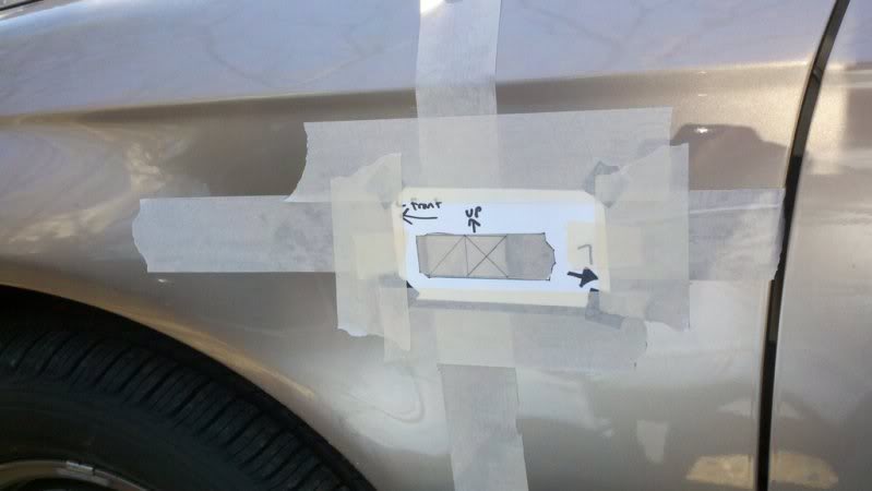

Made my template...

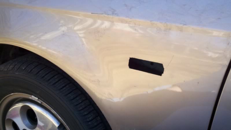

Cut, cut, do'h, cut, file. (cutting wheel exploded at 6000 RPMs. Missed everything but the fender.)

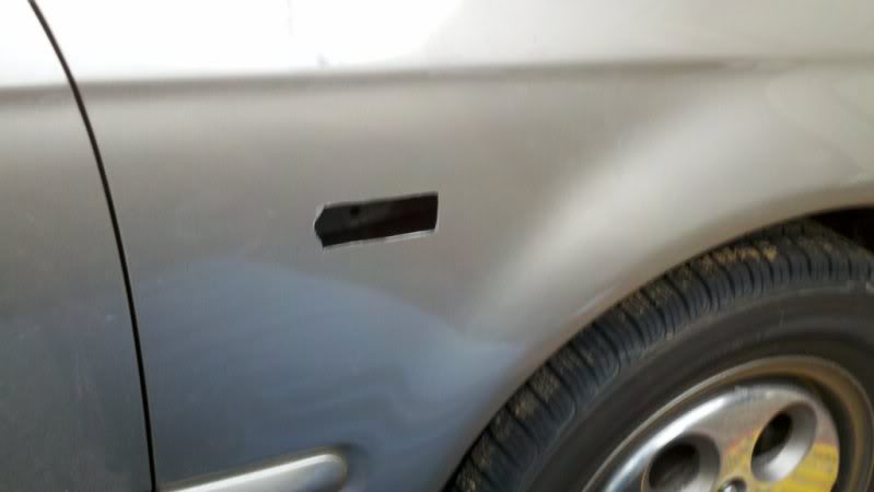

(lament giant scratch), paint edges, dry, add light.
It'll buff out.

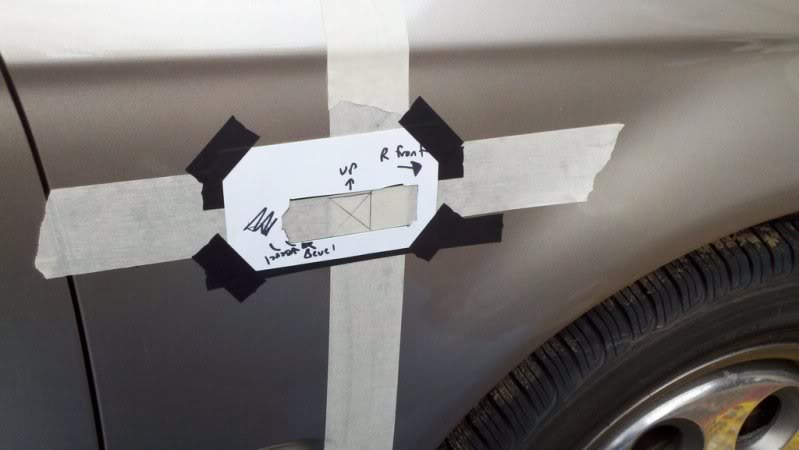

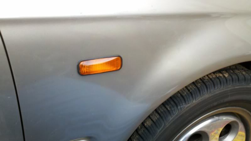

Applied the template...
Cut, cut, cut, cut, file.

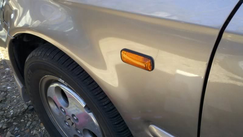

Painted edges, dried, put the light on.

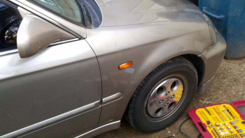

Jay dee em as fawk.
Seriously, I don't care about the JDM aspect. Since I converted to LED turn signals, they aren't as bright during the day. I need more light, so LEDs on the sides seem logical. These look stock enough. Better than ricer mirrors with turn signal LEDs on them.

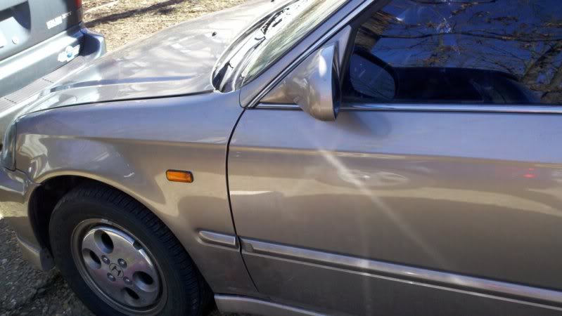

Night shots soon...

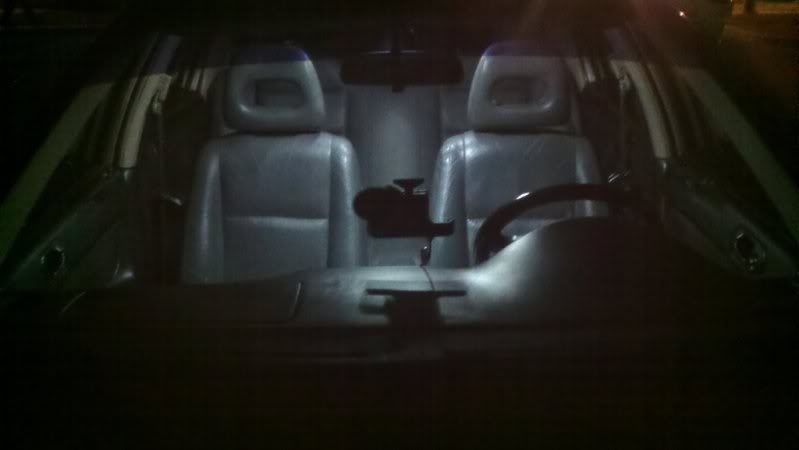

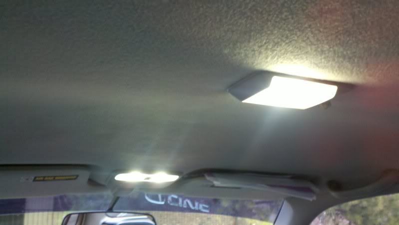

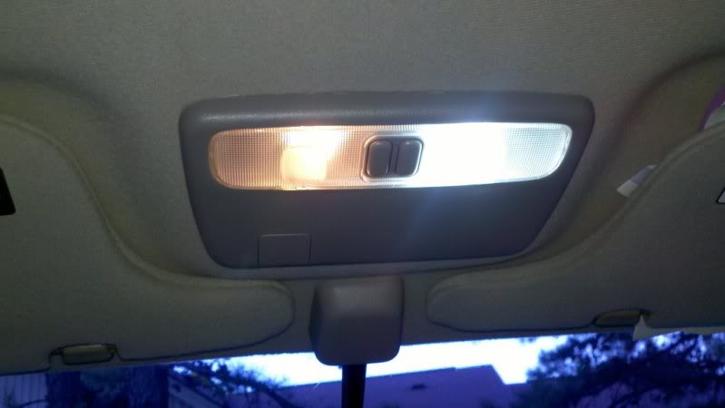

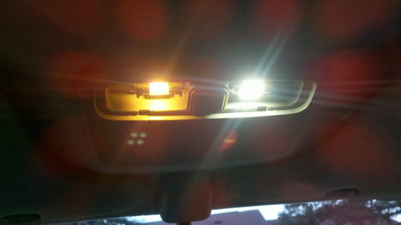

Night pictures. My phone can't do it justice. Three of those bulbs in one interior = BRIGHT AS DAY. I angled the dome light towards the back and angled the map lights straight down. Even light spread. (Excuse the junk in the car, you get the idea.)
