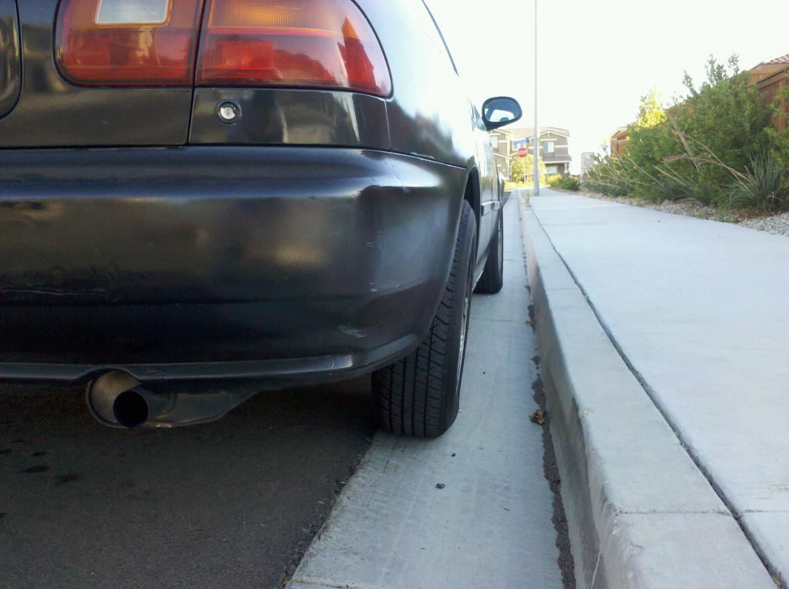

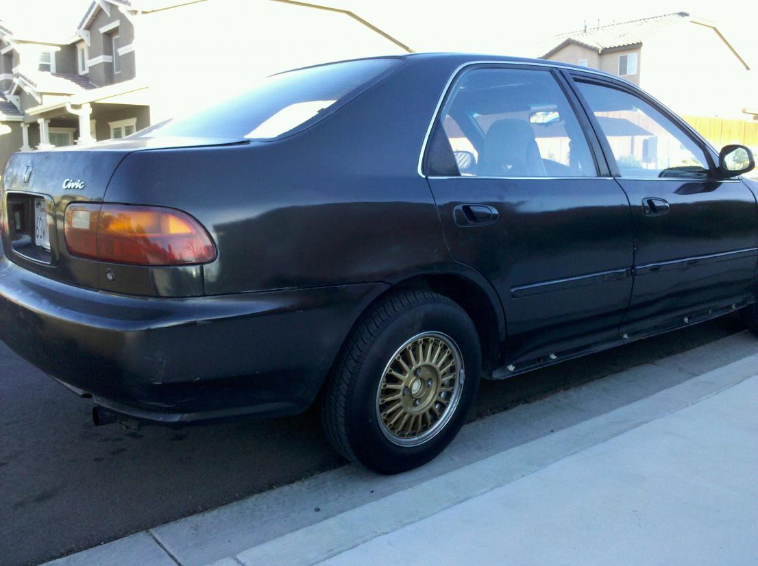

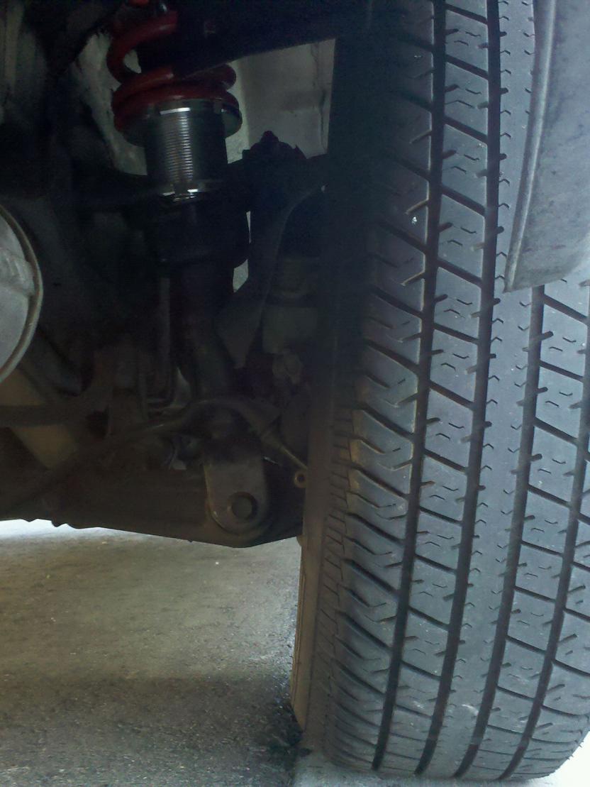

I dont know how it happend i bought the car and a day later i relized oh **** my tire looks funny.. its a 95 civic ex 4door it has a rear disc conversion and coil overs.. a buddy of mine said it could be my trailling arm but i havent had the time to really look into it cause of work.. just some help and some info on maby the price that would be cool guys thanks..

now to me it looks like the lower control is bent, and it looks like the car have been hit on that side at one time or another

Yeah that's typically what happens when you spin out and slide into a curb. Then slap a new tire on and sell the car.

wheres a good place to take it to to get it checked out? theres no dents on the body at all just the moldings have dings..weird

Take it to any shop and ask them to check and see if the alignment CAN be repaired on that corner, or if there is body damage.
You may need a new trailing arm or some body repair.

Ya I took it to get it aligned cause I know it needs an allignment and they saw the tire and said can't do it untill its fixed..so ill probly take it to maby like goodyear and see if they can check it out

They didn't tell you if there was body damage or rim damage or anything? Just "fix it first"?
